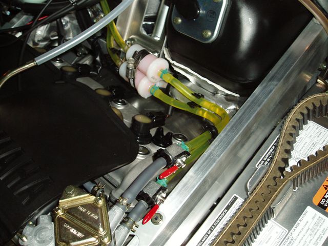

These pictures were provided by a friend who installed the shut-offs in an online fashion with OEM R1 inline filters. It seems that Rich's Yamaha in Lockport Illinois delivers their sleds with mud in the fuel at no addiitional cost! The sled's dirty fuel nearly cost him a motor and Rich's Yamaha did NOTHING!!! These filters are available at any Yamaha dealer. Good insurance if you don't want to tear your carbs apart several times to clean the crap out. I would think fuel cleanliness is even more critical on the fuel injected 06's . He did change the yellow fuel line to a red high temp urethane to match the 05' Warrior color; I kept the OEM gray.

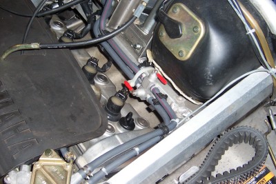

Here is a link to a pic of another way to do it. http://www.ty4stroke.com/files/thumbs/t_yeller.jpg there are a few other post on this subject. Do a search for my name and near the bottom of the page there are two more posts on this. One has directions and parts needed with NAPA part #'s for the ball valves.

Hi Todd,
Thats the same way I installed mine. Great job!

Fuel shutoffs
It appears that only the bottom picture has the actual shutoffs affixed to the chassis or frame. It is necessary to do so? I've never had an issue with my 03 RX-1 and have trailered all over the place. Is the reason for the shutoff if you ever tip the slef on it's side?????
SoCoRX1
My dealer told me that the fuel is automatically shut off when the motor is turned off. They said it was integrated and there is no need for a fuel shutoff valve he even showed me how it works. i have never used fuel shutoffs and i tow mine around any time i ride. they are always being pulled with a full tank.
