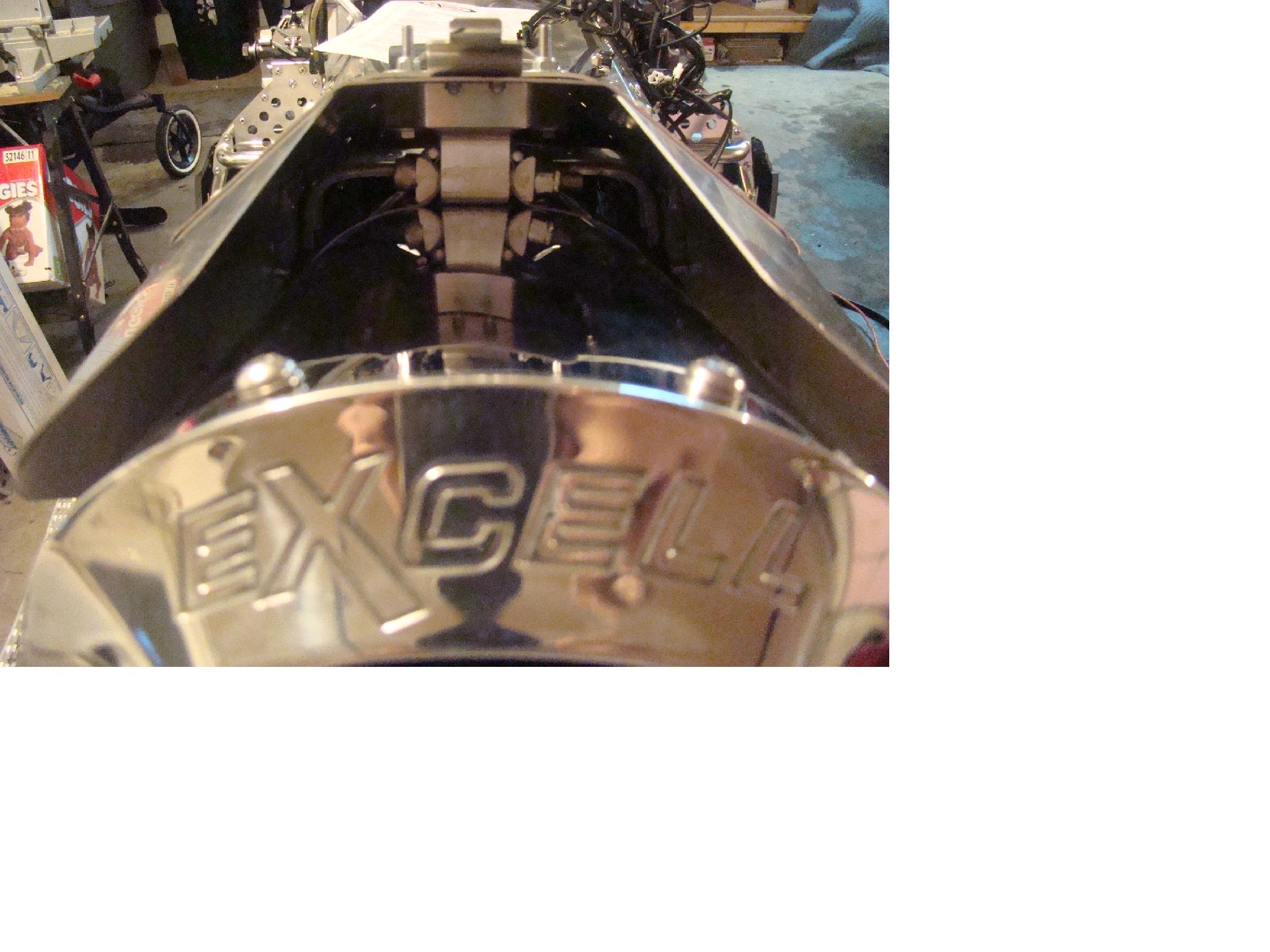

From what I can recall, there is only one part to the bracket and the two bolts. I will see if I took some picks of it and will post.
Hope this helps
