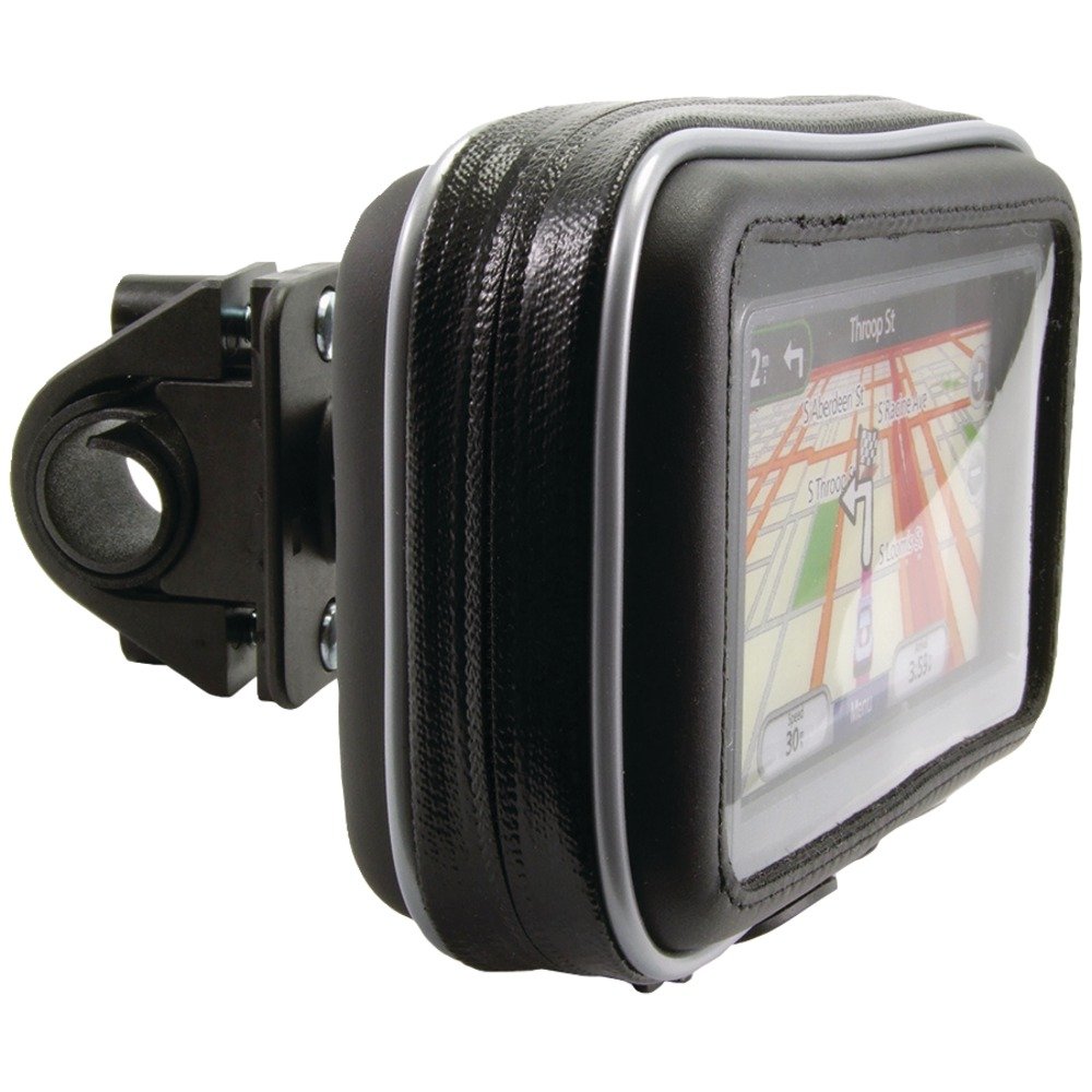

I got this for my brother for X-Mas, Price is very good for both on Amazon . Bought the Maps from Redpine mapping on Micro SD card . Garmin NUVI 42lm GPS.
It comes with a 12 Volt Plug .

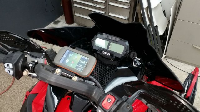

Here is my setup for GPS and cell phone...
This is the mount for GPS on my Apex
Here is the Viper mount on the left is for the Garmin Zumo and the mount on the right is for cell phone...
