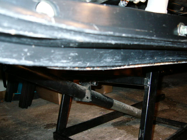

tundra
05 ski trail version
05 ski mountain version
Dooman your are trail version of 05 saddle less
