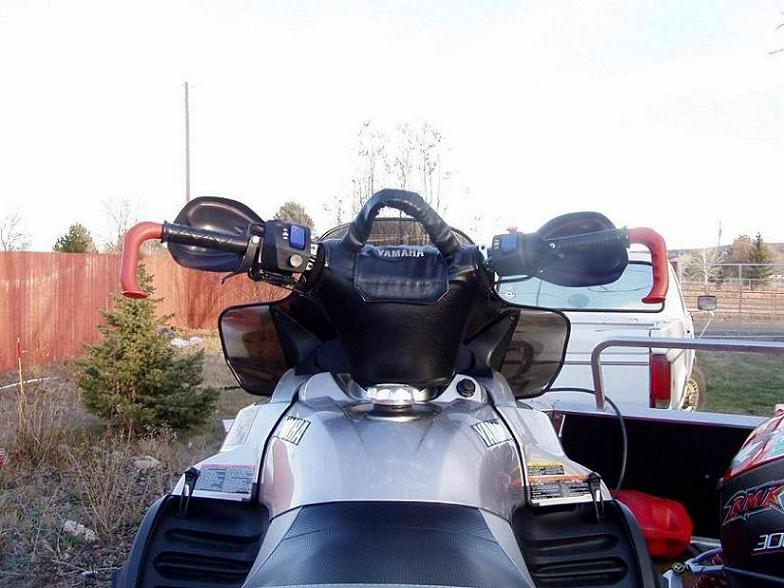

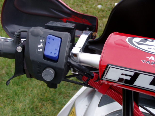

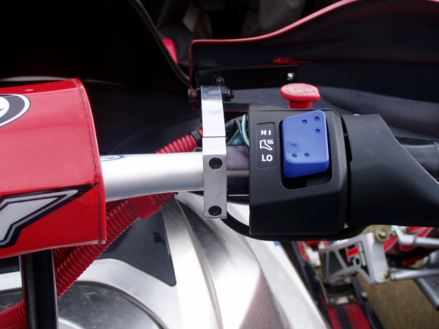

bigrock33,
Here are some pics. My Sportechs are mounted on my Fly Aero Taper Sno X Mountain bars the same as they were on the stock bars. I'm still waiting on my longer brake line and throttle cable so they will be missing in the pics. The left bracket rides just above the brake line though when it is installed and both sides are installed so that the brackets curve up and over the lines/cables. I have the small allen head screw that adjusts the angle of the handguards themselves inserted in the middle hole.
If you have done a left hand throttle the brackets might be close to the bend in the bars. This was the case with my '03 stock mtn bars. I just bent the handguards into place once they were mounted. The part that is riveted to the handguard itself will bend fairly easily.
Also enclosed is a view of the rear of the stock bars with the pad and grab strap on.
Jim.
