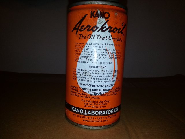

This will work if you can find it.

The best is to make your own, 50/50, acetone and automatic trans fluid.

Not yet. Gave the skis with my spindles attached to my neighbor who works at a car repair shop, as he said they would get that bolt out one way or another. Well 4 days later he returned my skis( with my spindles attached) and the bolt still rusted into the sleeve. He was surprised he could not get them apart. Also took them to my dealers mechanic, but he had no new ideas. Maybe I will try that product made by Kano mentioned by yamahaguys in a previous post, if I can find it.
