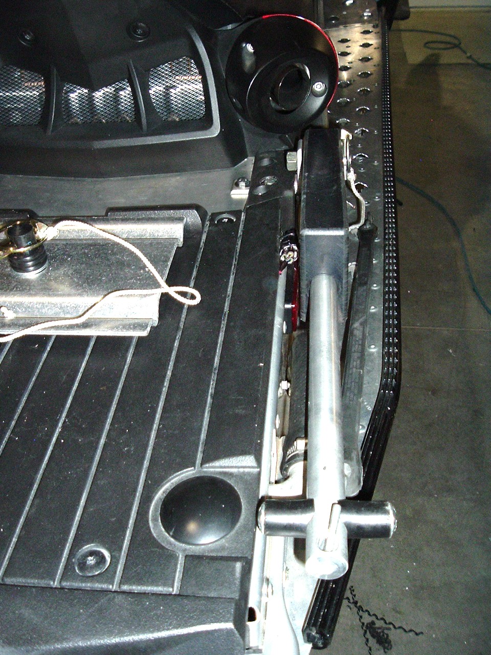

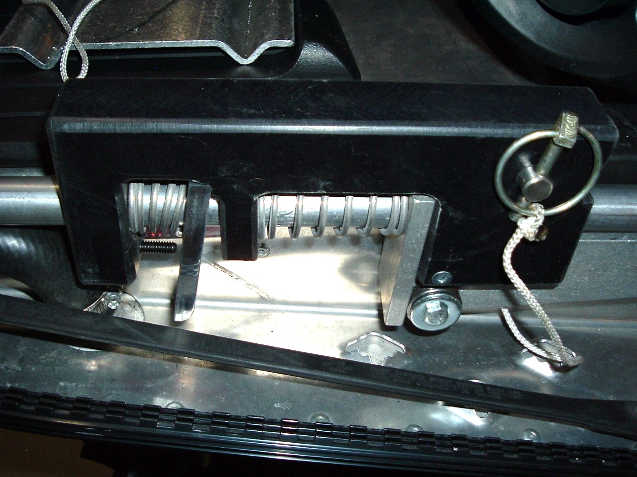

These are powder jacks I have mounted, but it's similar. 1/2 long 1/4x20 stainless bolt in the front clamp, from the tunnel facing out and a nyloc. clamp is 1" You can see the three rivets I added to the mudflap. The only other hole drilled was for the right front storage bag clamp.
And the lack of storage bag area is why I took my plastics off. They completely fill up the rear deck. My bag wouldn't even fit between it.

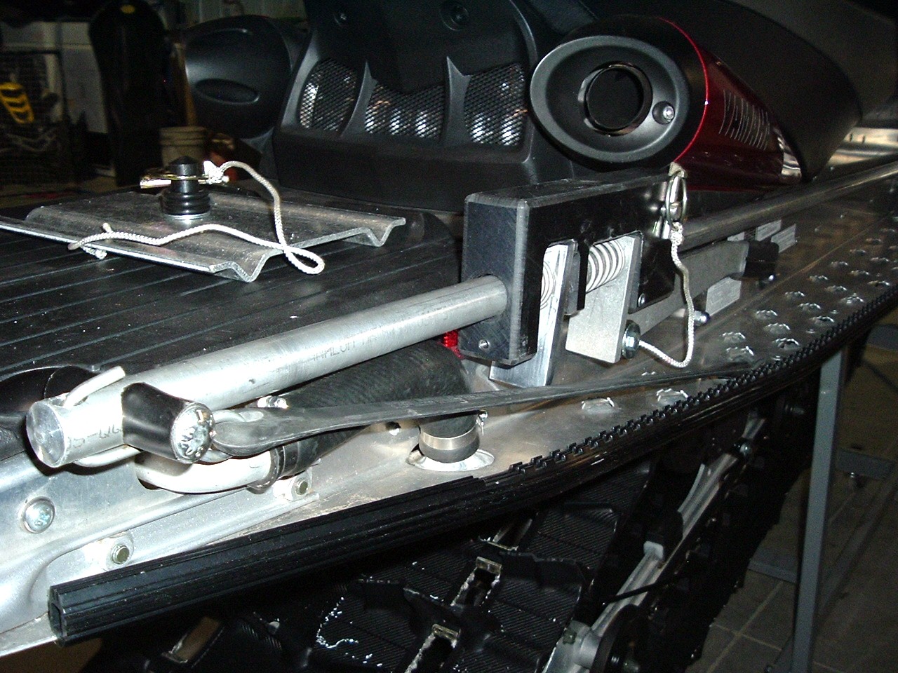

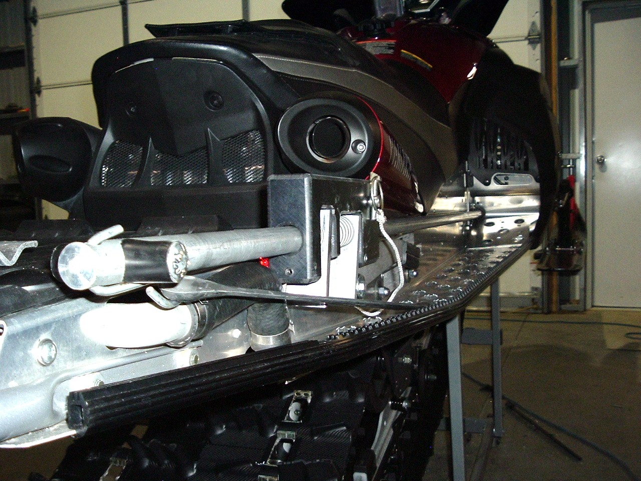

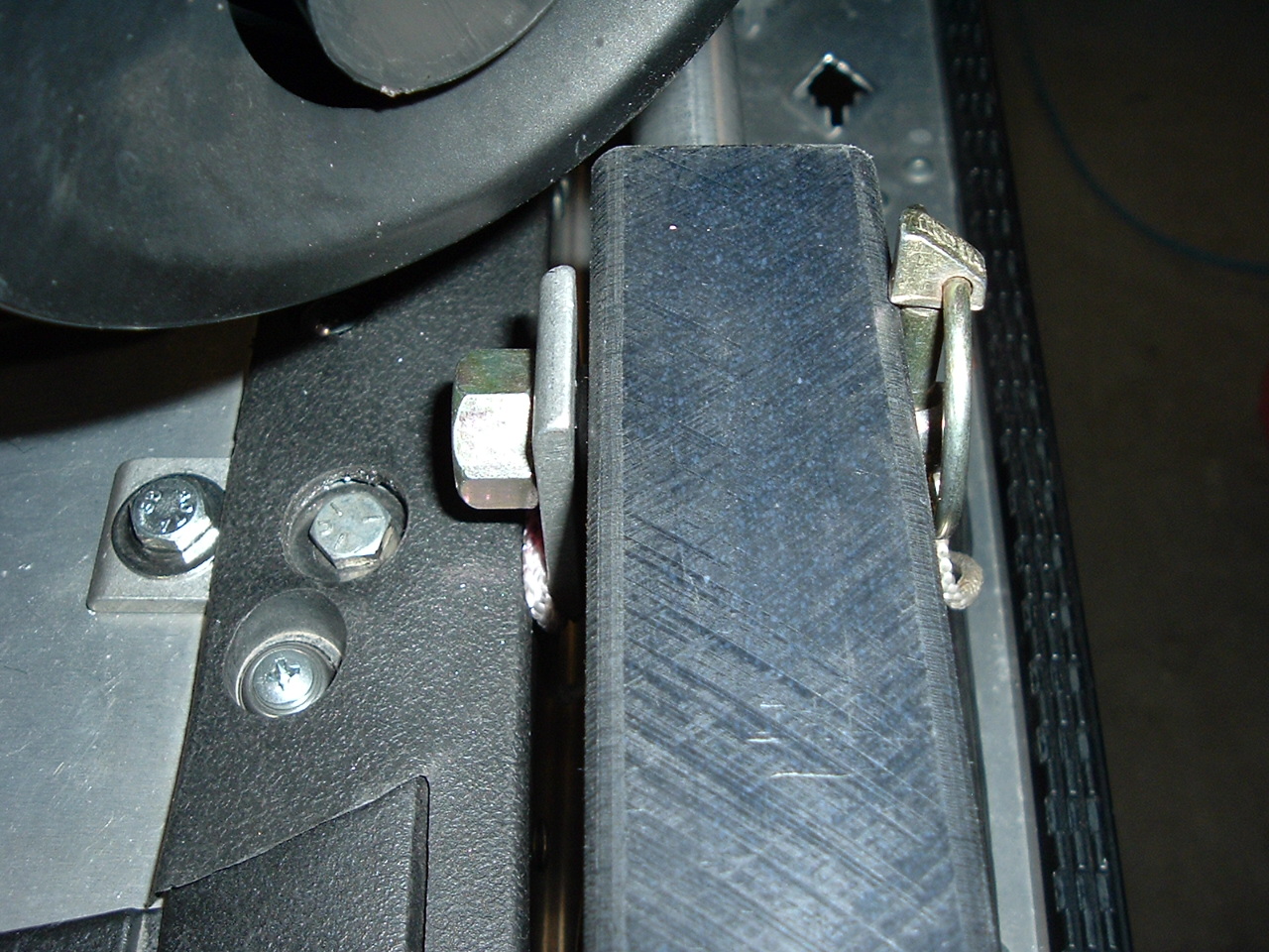

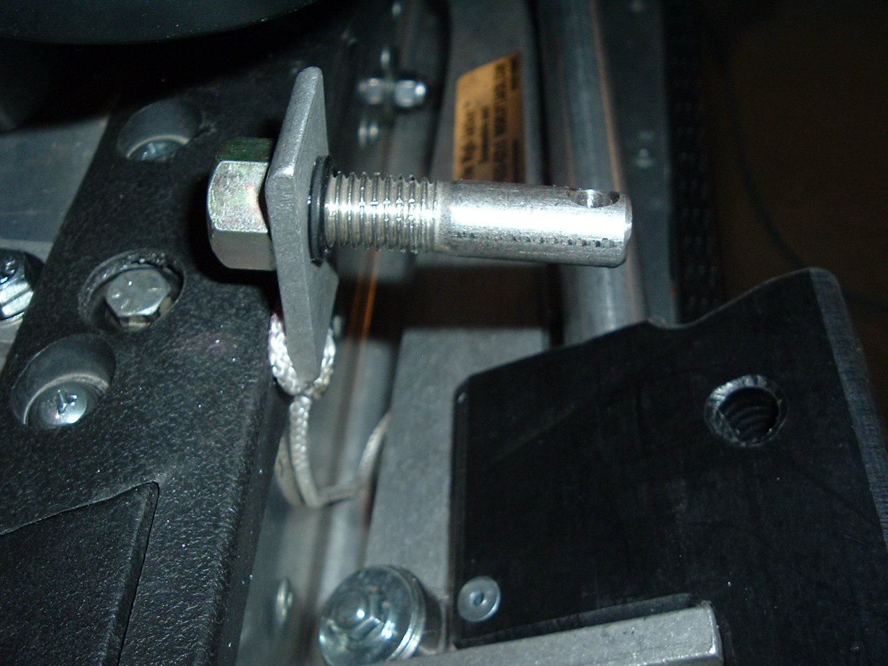

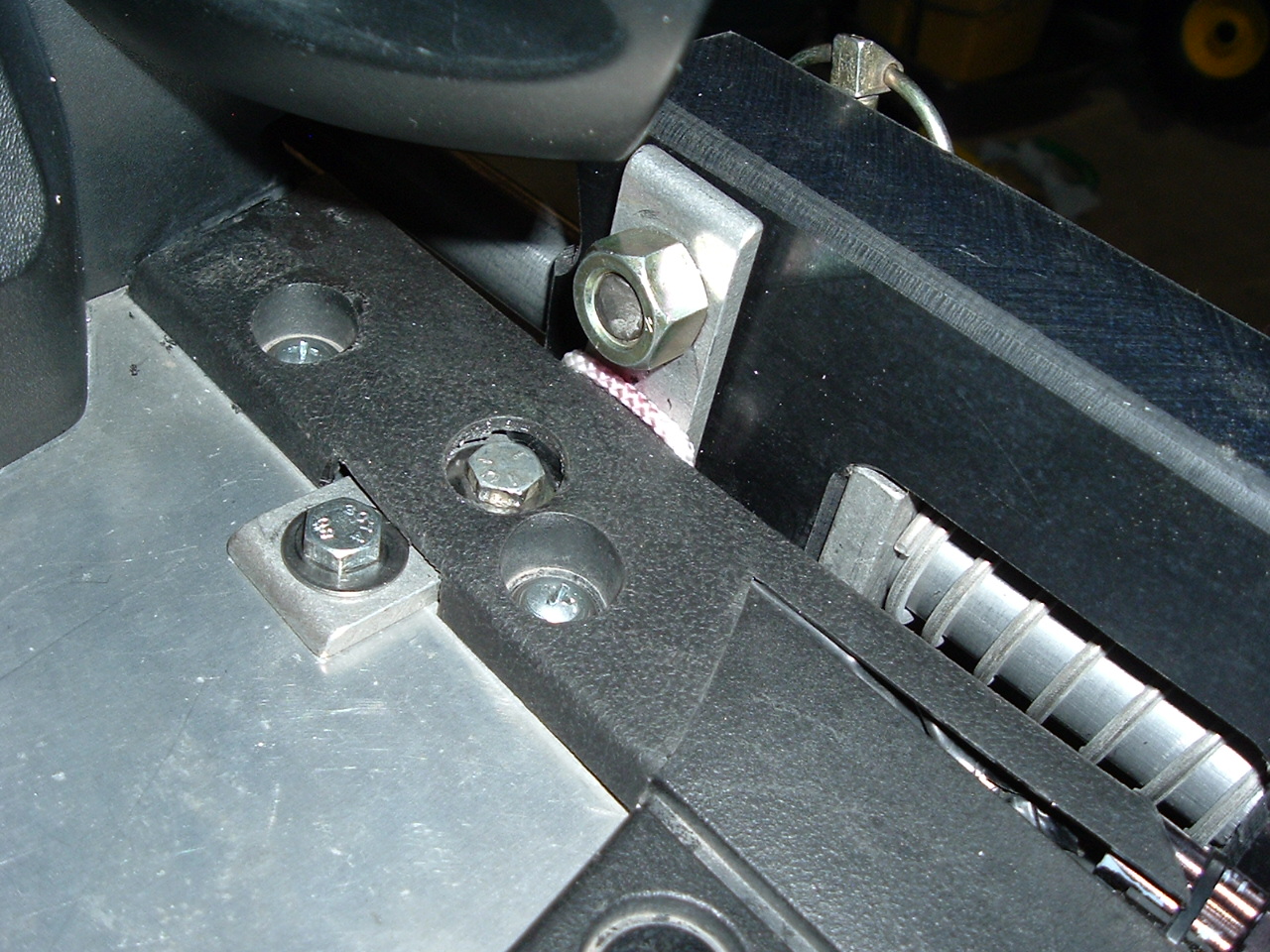

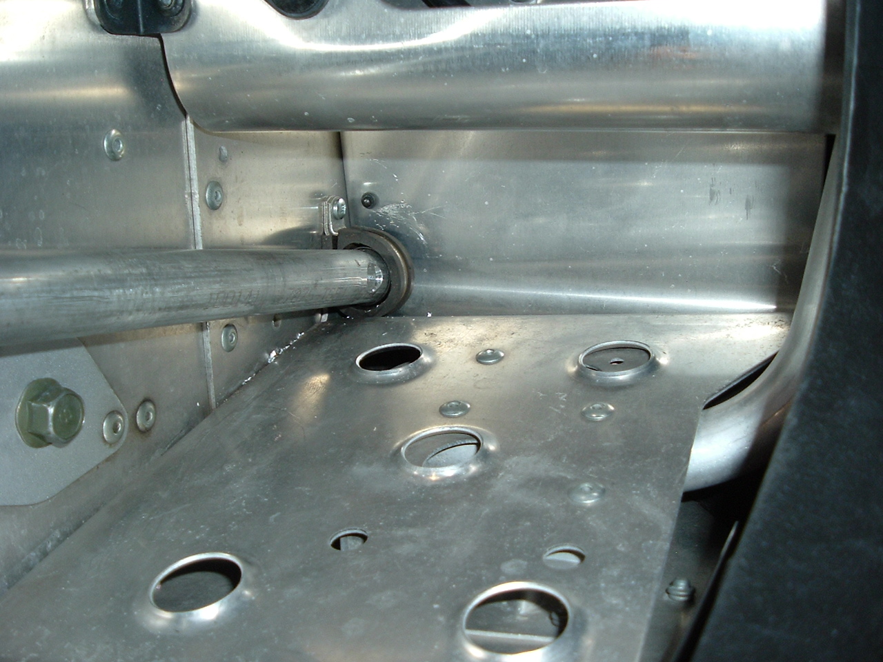

What I did... and don't even notice it's there while riding...
