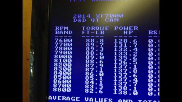

Where does the engine make its most power?
Most of the dyno results on the stock N/A motor put it right around 8900 rpms. There are guys raising the rev limiter to clutch at 9100 and not hit the rev limiter but it seems as if the curve levels out for a few 100 rpms and then drops off. This was one from D&D with their can on it from 8200 to 8800 rpms there is only 1 hp difference and the torque is already dropping off.
Oh and this was a 14, do you have the old motor or the new one? supposedly there is a few ponies more in the new gen 16 motor. Remember the total hp is not important because every dyno is a bit different.
