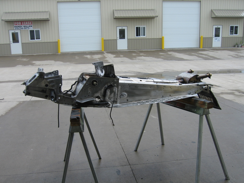

ualav8 said:do i hammer it from behind( the track side)? i cant seem to get a tool or anything behind it from the clutch side
Yes it can be a bit tight in there sometimes, I find by just REMOVING A FEW THINGS it really seems to help a lot
Glad 2 help u out
