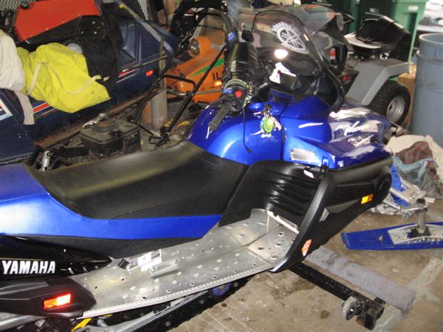

can anyone tell me if you can change the seat on an 04 rx1 over to a newer yamaha apex seat. if so what changes are required.

All you have to do is trim the tank cover and rework the rear wiring. It is easy. I have a seat for sal if you need one. Maxdlx

I have a how to in the FAQ section that details the wiring part o the job. Awesome mod!
sleddheadd
i did this mod to my warrior and i love it! its a lot cheaper than going and buying an apex! lol.... plus you get the satisfaction of doing the job yourself and riding your own creation! http://www.ty4stroke.com/viewtopic.php?t=45203
