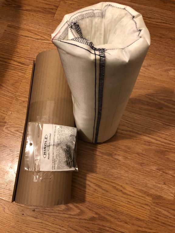

I have a hurricane hindle muffler on my 2017 sidewinder and it seems to be getting quite a bit louder and droney. Has anyone replaced the packing and is there a direct replacement muffler packing and rivet kit available for them?
UPDATE: Hindle does have replacement packing for the Hurrican Hindle muffler. The part number is MPOV12MX and cost 44$ CAN. The part number isn't on their website but they were very good to deal with on the phone. The kit comes with the replacement rivet and drill bit to remove the old rivets. Haven't tried it on the trail yet but it's definitely Quieter at idle! I ordered 2 one for me and one for a friend but he decided to put the stock muffler and tune on so I have one kit for sale if anyone is interested PM me.

Yes there is. I repacked my Excel but I used the wrong stuff and it didnt last. Get it from hindle.
