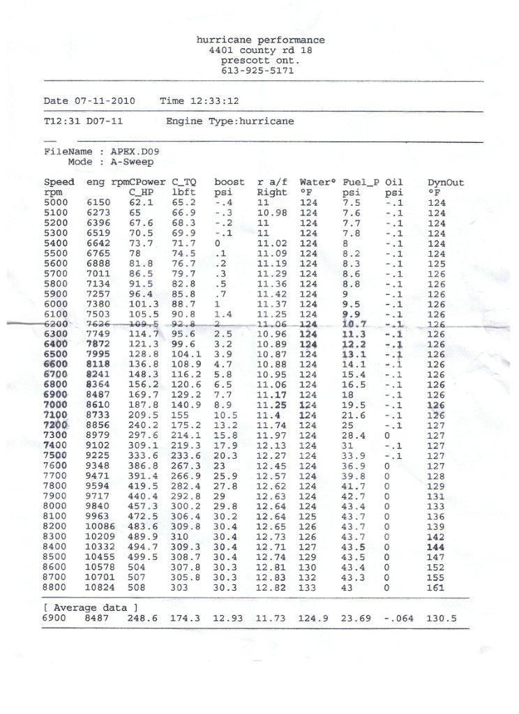

That's great power! Any way to post the dyno graph?
here you go Zeb

Thanks! X3 on the torque. Can I ask what turbo was used? If it's top secret I understand. :yam:
