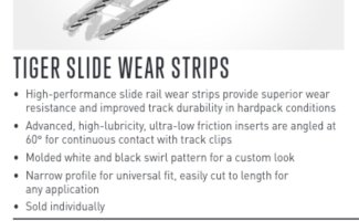

In the 2024 Cat accessory catalog there is a new slider offered. It's called the "Tiger Slide Wear Strip" Part# 8639-422. They have the Dupont inserts but are inset diagonally so that the strip is narrower than the regular dupont sliders. I'm headed over to the dealer to order them this week. They weren't available in the spring, but I figure if I order them now I might get them by the end of next season.Have them on my Sidewinder for 4 years now. They are a little wider and you can either remove the skid or a slight trim of a window on either side of the track to fit.

If it fits a Tcat, it will fit your Winder. #8639-422 is the new slide, the Dupont inserts are inset at a 60` to have a narrower slide like the stock slides, no price yet, but described to be cut down to any length.Are you sure the part # isn't 6639-448 ? .... at $ 135.99 per slide, sold in qty of 2 but priced each?
How can I find out if this part will fit my 2022 Sidewinder LTX-GT 137 ?
any help appreciated.
#6639-864 is the original Dupont slide for tracks 151"-162". #6639-422 is also the original Dupont slide for Tracks 121"-146". The original Dupont slide have the inserts set at 45` and are a smidge wider that the stock slides.

I don't see that part number listed anywhere... even on the Country Cat website.In the 2024 Cat accessory catalog there is a new slider offered. It's called the "Tiger Slide Wear Strip" Part# 8639-422. They have the Dupont inserts but are inset diagonally so that the strip is narrower than the regular dupont sliders. I'm headed over to the dealer to order them this week. They weren't available in the spring, but I figure if I order them now I might get them by the end of next season.
acpantera
I know, it's in the catalog but nobody knows about them, doesn't register as a real # at my dealer either....yetI don't see that part number listed anywhere... even on the Country Cat website.
