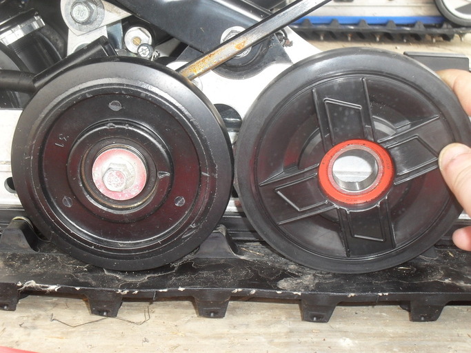

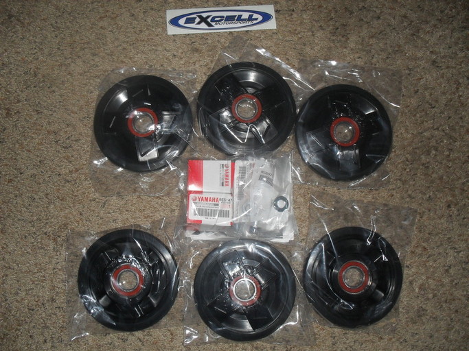

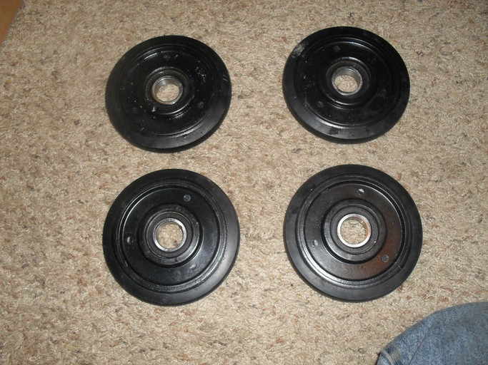

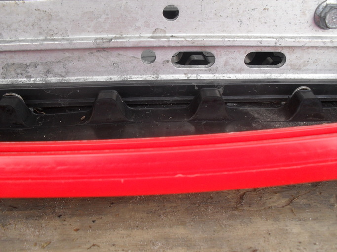

I ended up tinkering with mr SRX today. I decided to save the wheel project for tomorrow.
I noticed again that the HYFAX stops wearing at a certain point. They just wont go anymore and will last many miles after that. I still dont believe that something has to wear down so fast just to get to normal. I ended up taking some pictures of what the excell wheels look like compared to the stockers that are on it.
One of the pictures shows how much HYFAX has worn off with ONLY!! 501 miles on the ticker.
I am puttinf on the brand new RED HYFAX tomorrow you see in the picture. Notice how much wore off in 500 miles. The front still looks almost new on the factory HYFAX.
I will post a picture of the thickness of the old hyfax where it wore through the most tomorrow.

Thanks for the info.
I think am going to be happy with the excell kit. I don't like drill holes in my skid. Excell's Kit is a direct bolt on.
I dont have any trouble with front hyfax wear with the stock wheels so I'm not going to address it.

After I installed bigger wheels the wear at the front bend would stop and stay at about 30% or more left on the slides, in the worst spot.
Before, with the stock wheels, the hyfax would stop wearing when the track clips hit the aluminum rails lol
This was on my 09 rtx se. So I would try it with the bigger wheels, it might work for you. If not, throw some of those little wheels up by the bend.

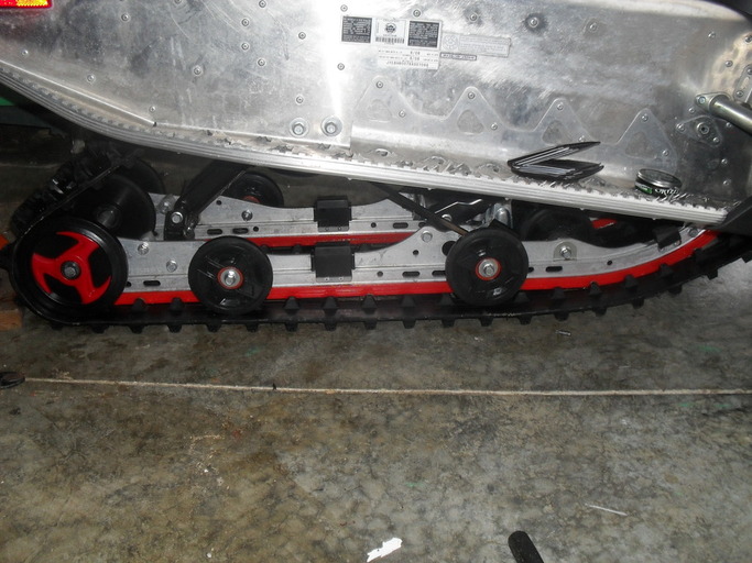

tomseal6 said:got the wheel kit on today with the new red HYFAX.
Looks pretty good I think.
That spring for the middle wheels OMG!!!
Looks good. I was going to make a suggestion about that torsion spring. You want to relieve the tension before you loosen that bolt...

I guess it wasn't mentioned but if you used a small ratchet strap (springs clinched forward) it holds them in place, it's no biggy.. and yes it look's sweet. When did you change the rear idlers to red?
By the way that's a classic picture.
A snowmobile with a wallet thrown on it!!! lmao
