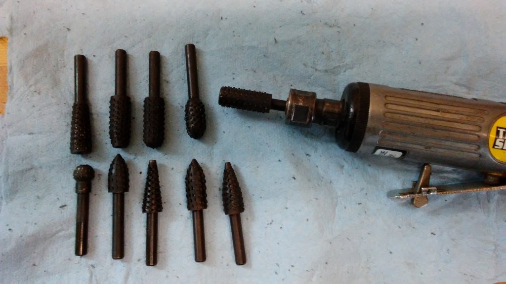

Have a '14 RTX and just made my Tri-hub bearings servicable. First i took it apart and then put a bolt through the bearing with a washer large enough to cover the bearing to protect it and tightened the washer/nut on the back side to capture the whole bearing. Next i clamped the bolt in my vice and then used my air grinder with a nerled tool (12 piece nerled tool kit from Harbor Frieght for $8.50). I ground out the plastic that makes up the inner beaeing hub down to the washer cast in place. I then removed the bolt and used a socket to drive the bearibv out to service it and put it back in. I left the inner washer out of the assembled tri-hub as the shoulder on the axle holds the bearing in the wheel.
