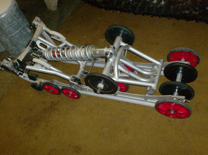

Ely if you are going to replace the wheels I would suggest going with the Excell X wheels, I believe they are the same price as the Yamaha wheels but a little bigger so you will solve any slide wear once and for all.

How much for the Yammy ones, Irv? I ended up chuckin' about $30 each for the Excell X ones.

Elypsis said:How much for the Yammy ones, Irv? I ended up chuckin' about $30 each for the Excell X ones.
I believe I paid around $25 each but it has been a while?
