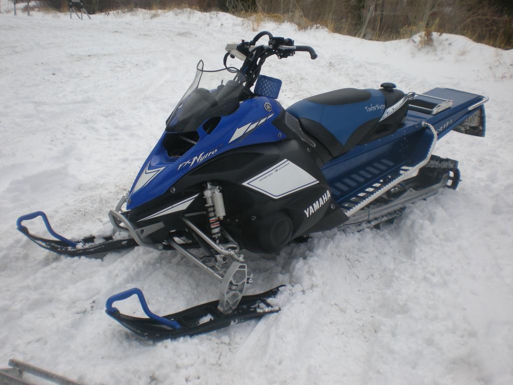

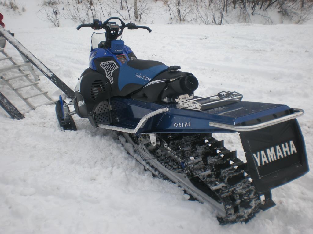

Impulse race kit done
snowy1
Sep 14, 2004
786
2
973
spring creek nv.
finally got it finished and took it for the first ride. everything worked great except the limiter strap broke first time i got into the throttle. the throttle response is unbelievable don,t think I have had any two strokes that had better throttle response. Impulse race kit, je 9.5.1 pistons, carrillo rods, timbersled suspension with iceage 174 rails, 174 camo extreme, crracing 174 tunnel,front heat exchanger delete kit and 8 tooth drivers, 8" 2 wheel kit, motelyone seat, two stages of nitrous, methanol injection, shockwave helix, supertips and radiator deleted.

Killer,Sick, Awsome, all of the above.
Just can't help but be curious, If you deleted all the coolers how are you keeping all that Horsepower in check?
Ted.
Ted Jannetty said:
Ted.
the crracing tunnel comes with a U cooler and I left the small cooler in the top of the tunnel, deleted the front cooler so that I could run 8 tooth drivers, and removed the radiator to fit all the nitrous and methanol in, I could make room for the radiator if I had to but after the first ride I don,t think I will need it, no cooling issues.
