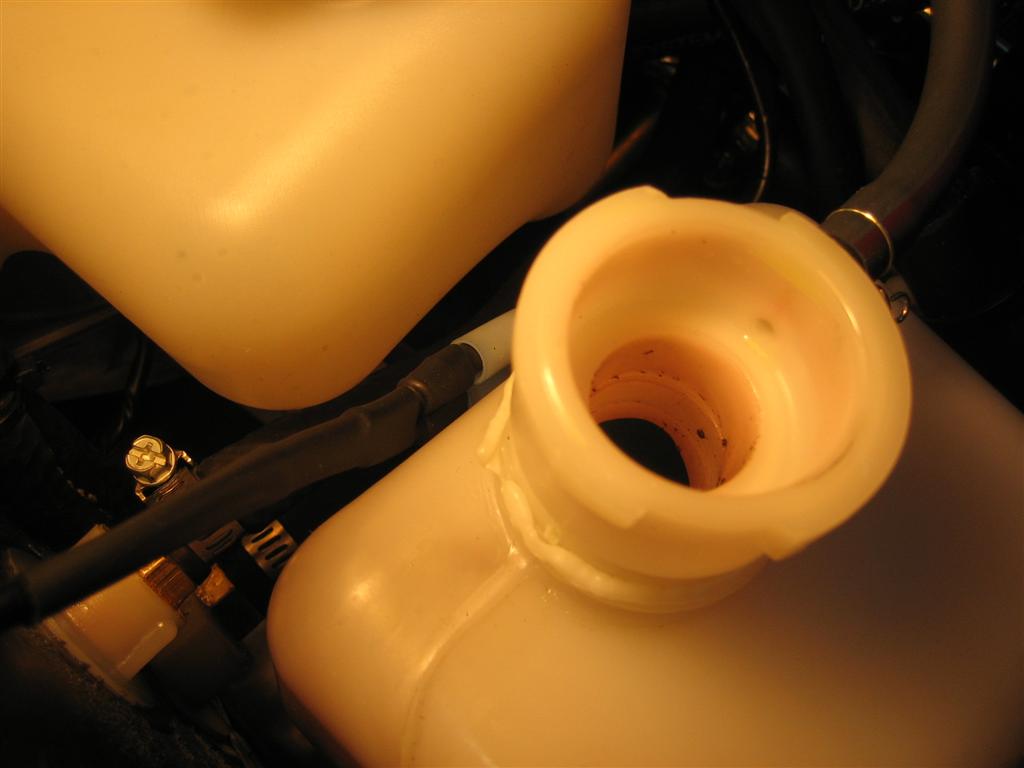

Well after 3 rides at 14 lbs I have the black flakes and head gasket sealer color in my coolant bottle. I noticed the flakes, color the first time that I rode it and got it up to operating temp. At that time it was only at 11 lbs. I am not loosing coolant and it is not blowing out the overflow at all. Could this just be the small amount of head gasket areas at each hole on each side of my head shim or am I looking for a bigger problem. I did have a small scratch in the head shim when I installed it but it was very minor.
The motor seams to run real well. What is your guy's opinions on this? Should I go ahead and pull it apart and install a new head gasket and retorque to Ted's specs??? What sealer are you guys using? I used permatex (red) it looks like it warms up and dripped down the sides of the cylinders and is hard as hell. Is this normal??

Black flakes in your coolant doesn't necessarily mean you have a problem. As you suggested, there are parts of the stock head gasket that have paint on them, and are exposed to the coolant passages. The bigger indicator of a problem is if you are constantly losing coolant, and have to keep topping off the bottle.
Get some more miles on it and see if the coolant level stays relatively constant (it will vary a bit depending on how hot the motor is).

I sprayed it on lightly to all surfaces. (No dead cat used!) once is warmed up it liquified and ran down the sides. It is not very good looking I agree!!! I did split the head gasket and put one half on each side of the shim.
There is a shim in that picture.
The coolant bottle picture is really not that color it just turned out like that in the picture. It only has a very light hint of red on the inside. The bottle is still white.
