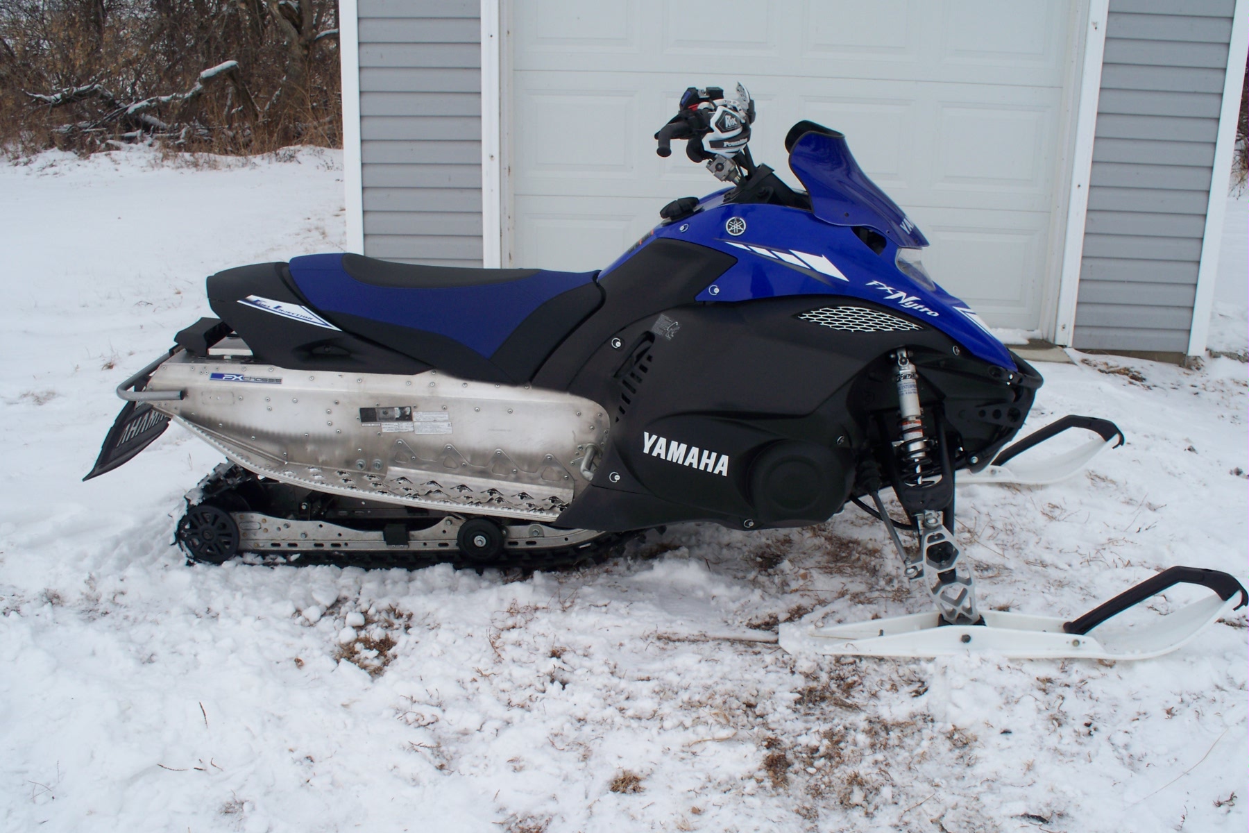

Is there anyone is the states that sells this relocate kit for Star suspension? Here is my 08 with the 128" Tracks USA extensions and 1 3/8 cobra track.
