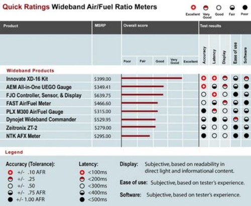

Make sure you have your LC-1 oxygen sensor operating before you run your engine otherwise the hot exhaust gases can quickly damage it. Excessive moisture in the exhaust will also damage the sensor. It is recommended the sensor be mounted between the 10 o'clock and 2 o'clock position. Innovate warns against using leaded gasoline as the wide-band sensors were designed for unleaded. Using them with leaded gasoline significantly reduces the lifespan of the sensor. In most cases (depending on the volume of lead in grams per gallon) a wide-band sensor will provide accurate measurements somewhere between 50 and 500 hours with leaded fuel.
Quote above from this website:INNOVATE MOTORSPORTS now has an even more affordable permanent install kit then the LC-1 with XD-16 gauge. They came out with the DB Gauges, these kits come with the gauge, an LC-1 wideband controller, oxygen sensor & bung/plug, and LogWorks engine-tuning software. For 289$
http://www.mx6.com/forums/fe-dohc/204337-wideband-shootout.html
Cool new gauges below that go with the quote from the above website:

Yes, I've seen that report before. My opinion is that the FJO is a better quality product. I see posts from guys fairly often that are having some type of issue with their Innovate gauge. The original poster advises me that he has 3 other customers that he's sold the Innovate to that are all having issues. Granted, I sell FJO gauges, so my opinion should hardly be considered un-biased, but 10 minutes of searching this forum and I can find posts up the wazoo from people having issues with their Innovate, I can't find a single one for the FJO product.
Complete FJO Widebands are available from BPE for $357.00.
Mark down another to get rid of the POS that the innovate is. It work for the first 100 miles then went nutso. Installed the correct way no leaded fuel, just freaked out reading all sorts of jibberish. I solved the problem to by ordering a FJO set up from Lakercr
