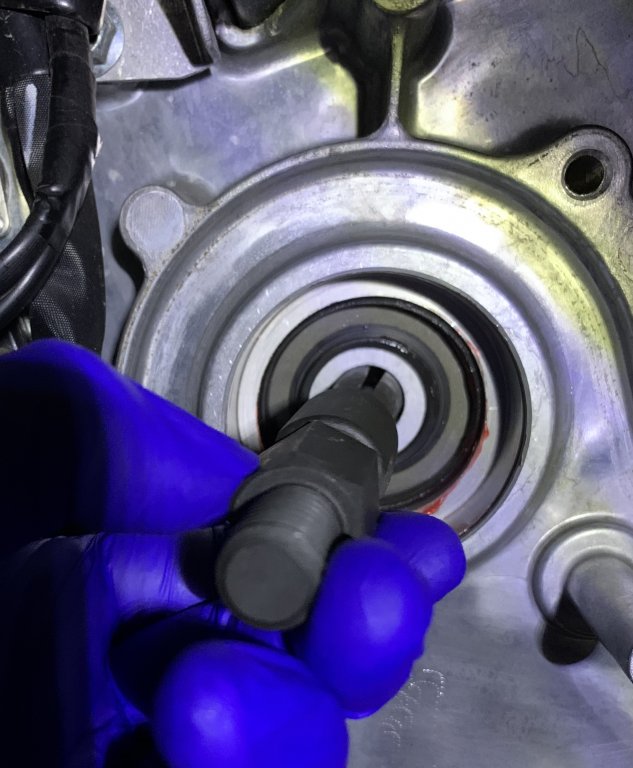

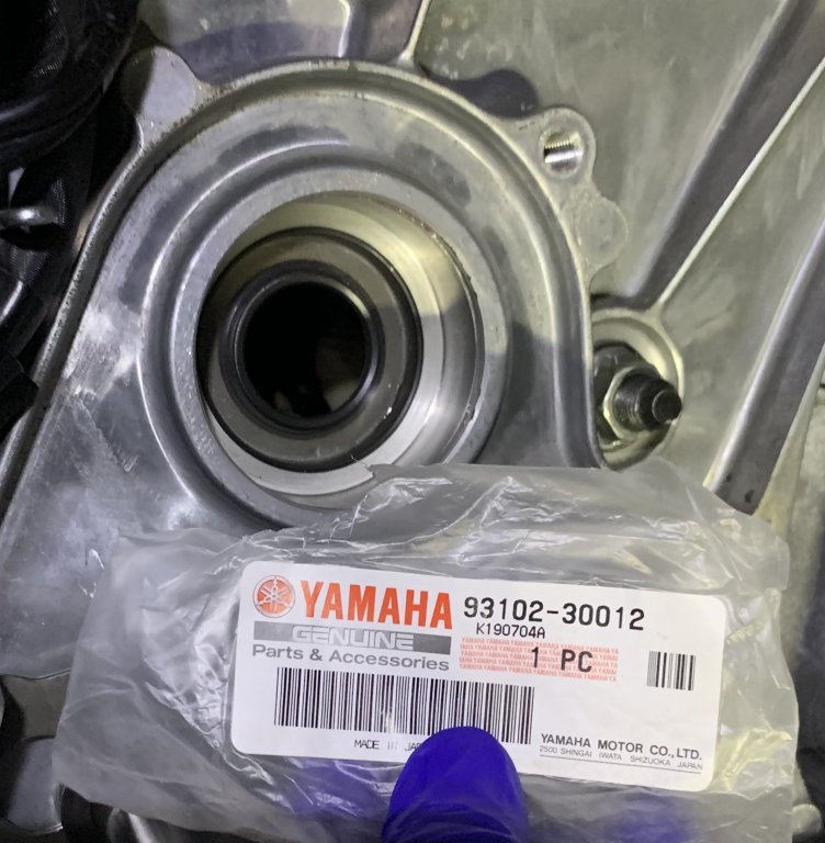

I was able to install the oil seal in the chain case last night (yamaha # 93102-30012). Since I was already in the back door (clutch side) I used a washer and a blind hole bearing puller, with a Lucas red and tacky grease, to pull the oil seal towards the chain case.
I noticed that there is a lip that was catching if I tried to push the seal in from the chain case side (pushing the seal towards the clutch). I think that if you go through the sled from the clutch side and pull the seal through, towards the chain case, you don’t catch that lip which is how I ripped the first seal. You can see what I mean in the pic below.

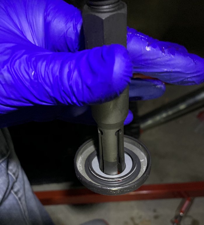

Here’s what the blind hole puller setup looked like with the washer on the back side of the seal:

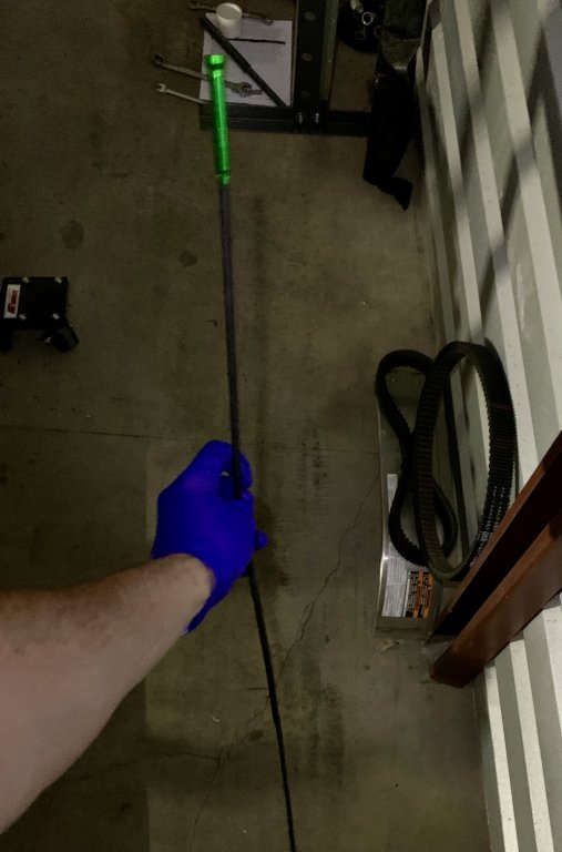

Had to use a reach extender with magnet to get the washer and seal through the sled

Used the blind hole puller to gently pull it through
