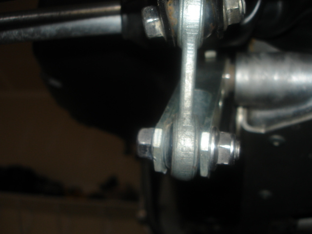

It looks like they are binding at the sway bar Il post a pic so you all can see.

Here are some pic's.
Kevin Garceau
Im sure is an optical illusion....but it looks like one set of A arms is longer than the other.

The left shock(when sitting on the sled) isn't totally extended. Take them both off and meassure eye to eye. You don't want to hear it, but my guess is one of them is bent enough to stop the shock from travelling. Either that or you have a big air pressure diference. Don't think binding in the sway bar links would be enough to hold the whole sled(even the track isn't sitting flat) off kilter like that.

It was never like this until I removed the old A-arms and put the new ones on. I haven't had to much time to mess around with it, but I did notice that when i leaned on the front end there was a very high pitched squeak coming from the left side (inside the engine bay) almost right where the sway bar is. So I tried to move the links around as seen in the photo and they are just totally wedged in there.

Should the sway bar connection look like the way they do in the pic's??

It should be easy enough to disconnect one end of the links on each side? That would get that sway bar out of the picture for a moment, and you could see what's going on then? That might be a good first step in your troubleshooting process.

Well, I still think you need to remove the shocks to locate your bind then. Will need to disconnect the sway bar from both sides to move the suspension through it's travel. If the a-arms move ok by themselves, and the sway bar moves ok (tie the a-arms up at full travel) and the hiems in the links are loose or semi sticky, then it has to be the shocks. You can check the bar links really quick by dis-connecting both sides(both incase the bar itself is bent). Process of elimination!
