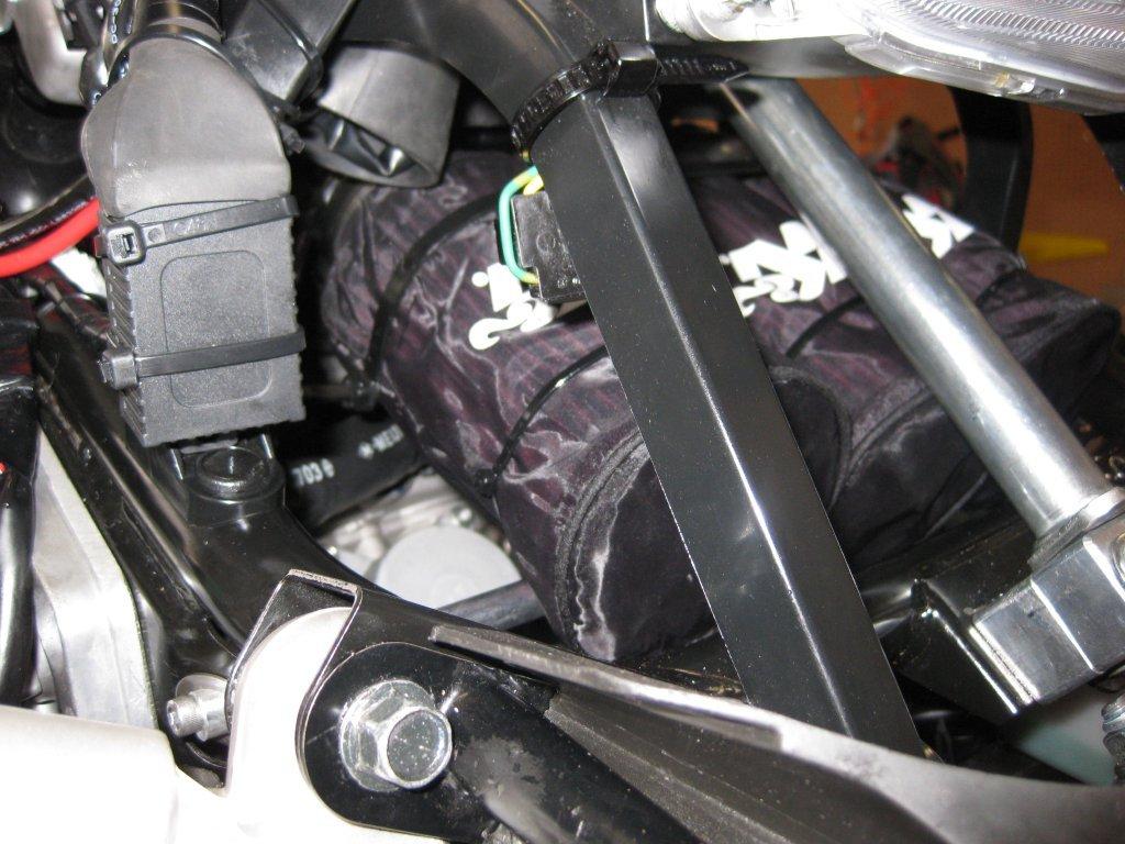

I recently replaced my airbox with a set of K&N filters. Everything about them is way more than I expected however I have had an issue with keeping them on the carbs. I do ride hard and the machine has seen its fair share of air and bumps.
Has anyone put any additional support for these as yet and if so would you please post some pics.

I just zip tied the bejesus outta em! To any spot that worked not 100% tight just snug to let them move a bit on the large hits!

I ran a 1/2 inch aluminum bar though the subframe gussets just below the front of the filters. Cut angled bushings, threaded the rod and then bolted on either side of the subframe then zip tied to it. I was really happy how it turned out and appears bullet proof.
http://www.ty4stroke.com/download.php?id=70552
