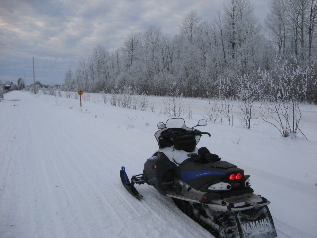

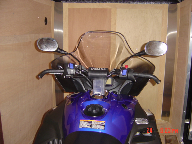

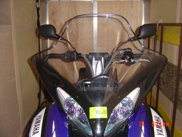

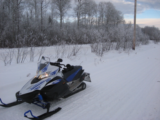

I have the "tall" windshield on mine, I bought it as a second and did NOT come with the support bars but DOES have the holes for the supports. I have not had any trouble with the windshield folding back while riding. From my experience, you do NOT need the supports.
Thank you also for the pictures, they came in handy.
