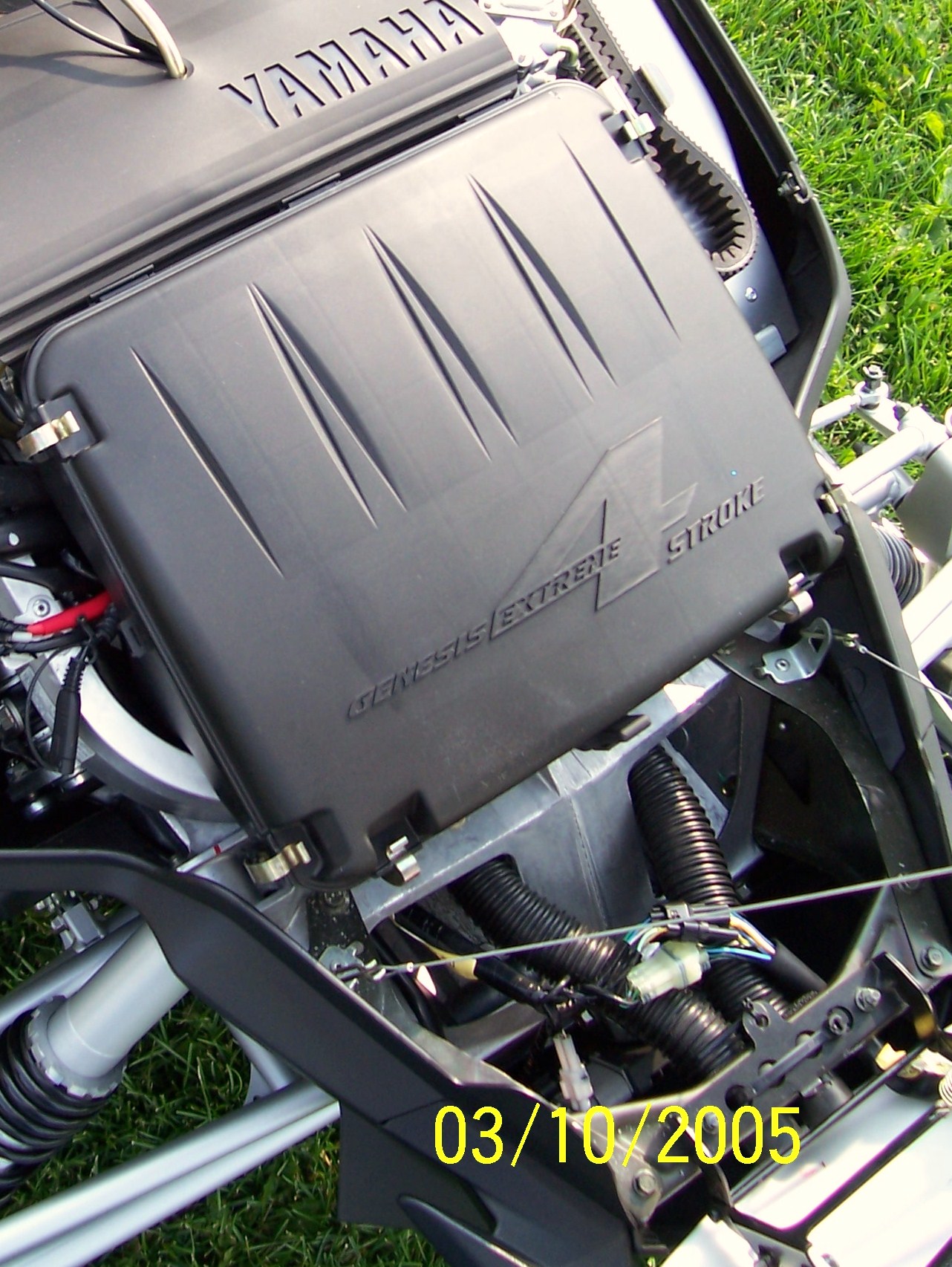

rightarm said:MJ/147.5,green springs, ram air,NGK Race plug equivilent to 10's.

JDMCRX said:I like this ideaOnly prob when u suck up some snow. You have pics of the bottom of the air box
Josh
Never had a single issue with snow ingestion in the 4 years I've owned it, the two ducts go to the bottom of the air box right above the ECU where the rubber snorkel protrudes.As well I am using the stock filter.
rightarm
Josh

No im not saying you will have a prob. Its a awsome idea. YOu have a pic of the inside of the bottom box
rightarm
No worries,I have no pics of the bottom of the Airbox sorry,but the Airbox itself is completely stock.Because the tubes are grooved the airflow is slowed comparing to smooth ones, still flows quite a bit when you put a hair dryer at the front and your hand at the other end.
