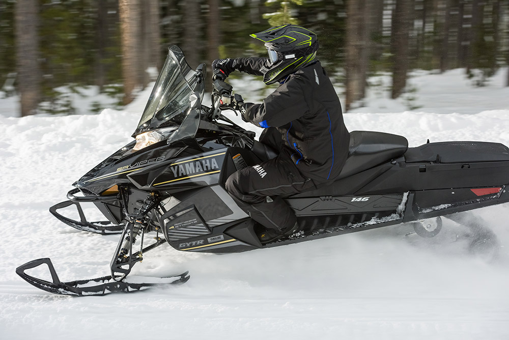

Hi folks, I'm looking to replace the factory 'nonexistent' "windshield" on my new 2017 SRViper X-TX SE. I really like the looks of the stock windshield on the 2016 SRViper S-TX 146 DX (seen here: http://www.supertraxmag.com/graphics/uploads/022515_VIPER_BIG1.jpg ) I'm a trail rider who wants to stay warm in colder (down to -20F frequently) weather. I would have bought a S-TX 146 instead of the X-TX, but I couldn't pass up the deal I got on the X-TX.
Looking at the parts lists online, I see that the part number for the 2016 SRViper S-TX 146 DX is
8LJ-K7210-00-00
I can buy one online for about $150, but I was just going to buy either a "Medium" or "Tall" one from the Yamaha accessories for under $100. Those are part #: SMA-8JP96-20-00 and SMA-8JP96-30--00 respectively.
Are the Accessory Medium/Large windshields that different, or does either of them match the stock 2016 SRViper S-TX 146 DX windshield? Do they really make different windshields for stock vs what's available as an accessory? If not, why the different part numbers?
What should I buy to replicate the stock 2016 SRViper S-TX 146 DX windshield at lowest cost?
Thanks in advance!

The stx dx 146 and the Tall windshield are different. The stx dx windshield is bigger , the sides come out and down more.

Thanks Allan, that helps a lot! I didn't notice the difference in the sides.... I have been able to find some pictures that show the differences between these options that may help someone else, so I'll post here. From what I can gather, the most wind protection will come from the DX windshield that you can only get by ordering the part number, it's not available as an accessory. I believe they come pre-drilled for mirrors.The stx dx 146 and the Tall windshield are different. The stx dx windshield is bigger , the sides come out and down more.
