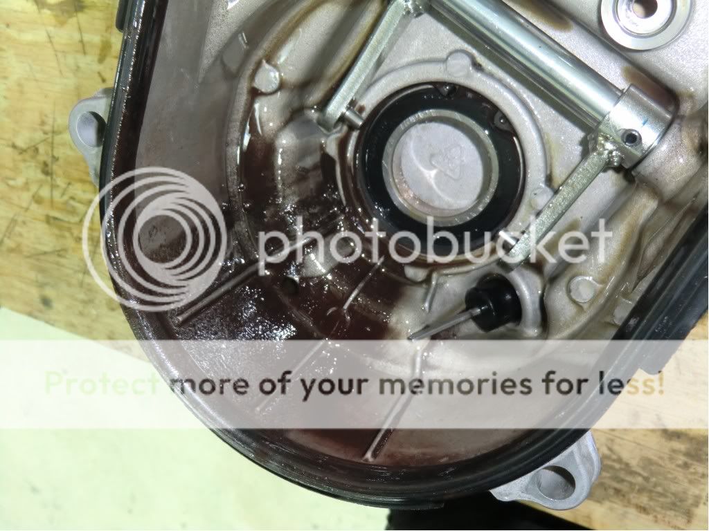

got a question guys..
i removed my track on my xtx an getting ready to put the 2" on.
when i opened up my chain case, the lower bolt was broken.. i bought a new one as a precaution ( dealer told me they changed 4 times the design/material of this bolt) ..no biggie there..
i decided to clean the interior of the chain case with some brake fluid to inspect everything.. the lower bering .. the one in this picture got pretty noisy afterwards.. but tit's tight..no loose so technically it's not needing any replacement.. i think..
so i decided to put some oil on it to see if the noisynes would go away and it did..
my question is .. since i can't see the other side of this bearing.. does it have the plastic shield thingy on the other as well to keep the grease in?? i think with that brake fluide i might have cleaned that out and little too much... or does it lube itself with the chaincase oil ???
this is a typical pic found on the web.. not mine..
nitris223
- Nov 18, 2012
- 589
- 32
- 778
- Yorkton Saskatchewan
- Yamaha Nytro MTX
There should be a seal on the other side as well maybe not I have yet to change one. . With a dental pic you can pry the seal out and have a better look and clean out any metal filings that may be in there, you have to remove the snap ring to get the seal out. You can give it a shot or two of good quality grease for added measure but I think the chain case oils seeps in there. With the pic go towards the inner race and slide the pic under the seal, move it around the race and you will feel the pic drop into a small void, that is where you can start prying. Go easy because the seal is rubber coated thin steel and it will bend.
On some of the sleds I have worked on that had two rubber seals and were filled with grease, when I cleaned them I would drill very tiny holes in the seal to let gear oil get in there. Some brands sleds will have the seal on the backside and the front side open to the chain and gear oil.
meskie
There is a seal only on the one side of that bearing. I've seen it from the outside of the case. Lol. That wasn't so much fun
