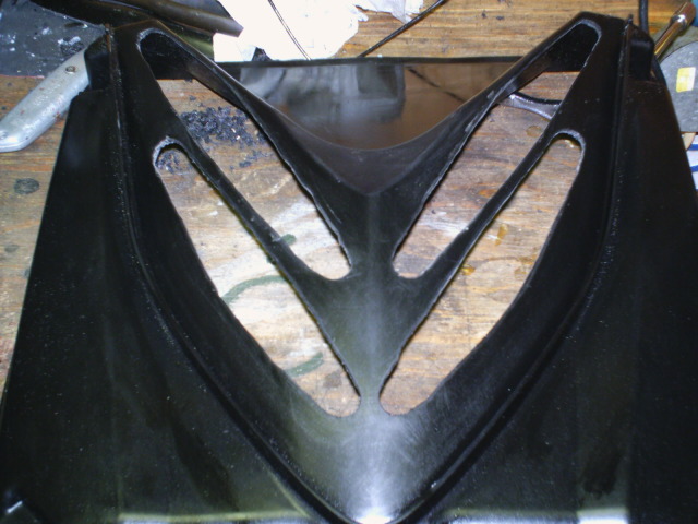

I did a search and found plenty of info on how to make a modded airbox, but nothing telling me if I need a EFI controller.
What I am planning on doing is cutting out the raised portion of the lid like ROCKERDAN did and attach the K&N filter material like apexg88 did.
I am also planning on gutting my stock exhaust for a little more grunt. Does anyone know if I will need a EFI controller if I do what I plan on?

Thanks for the info everyone! Should be able to start the cutting next week and will take plenty of pics in case anyone needs them.
pure
pure
What i did to mine was used a DREMEL and removed the front side of the two bumps on the airbox--so its like a scoop--then got a old screwdriver red hot and smoothed the edges--some outerwears on the backside with crazy glue for plastics.medium to low intake bark,and it put my sled in a sweet spot-- no adjustments necessary--the other two bumps i left alone.more airs going in for sure.just some ideas for you.sorry no pictures good luck.

tomanytoyz said:What i did to mine was used a DREMEL and removed the front side of the two bumps on the airbox--so its like a scoop--then got a old screwdriver red hot and smoothed the edges--some outerwears on the backside with crazy glue for plastics.medium to low intake bark,and it put my sled in a sweet spot-- no adjustments necessary--the other two bumps i left alone.more airs going in for sure.just some ideas for you.sorry no pictures good luck.![]()
Can you snap a pic and post it?
Thanks!
