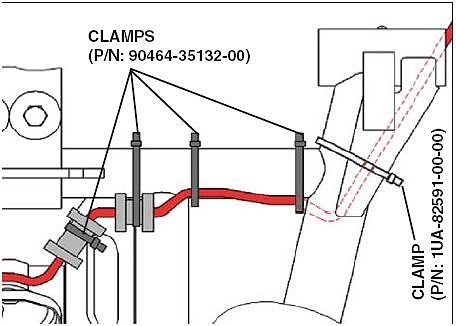

Guys I finally got the track and shock rebuild in but I am sorry to say I can not find the pics and instruction for routing the E shock wire. The search function and I do not seem to think the same. I know the problem lies with me.

its in this thread good reading on how to zip tie...use alot!!!
mr. shide
i had no idea how to re-zip mine. i just used a little common sense and lgic. routed in and around and through the arms and braces and holes. put about 6 or 7 zipties in strategic places. Looks like it should be good. I just now looked at the link from the update mentioned above. mine is routed similar to that except I think I did mine with a little more overkill!

Mr. Shide I did the same -with out the loop out and turn back on self and anchor around shock -and it cost me big, many of us did the common sense approach with overkill and it did not work.
I do not mean to disrespect your plan, or anger you, I just thought if it was me I would have rather been warned than have to replace the solinoid and all the wiring as I had to do in 08. Good luck.
