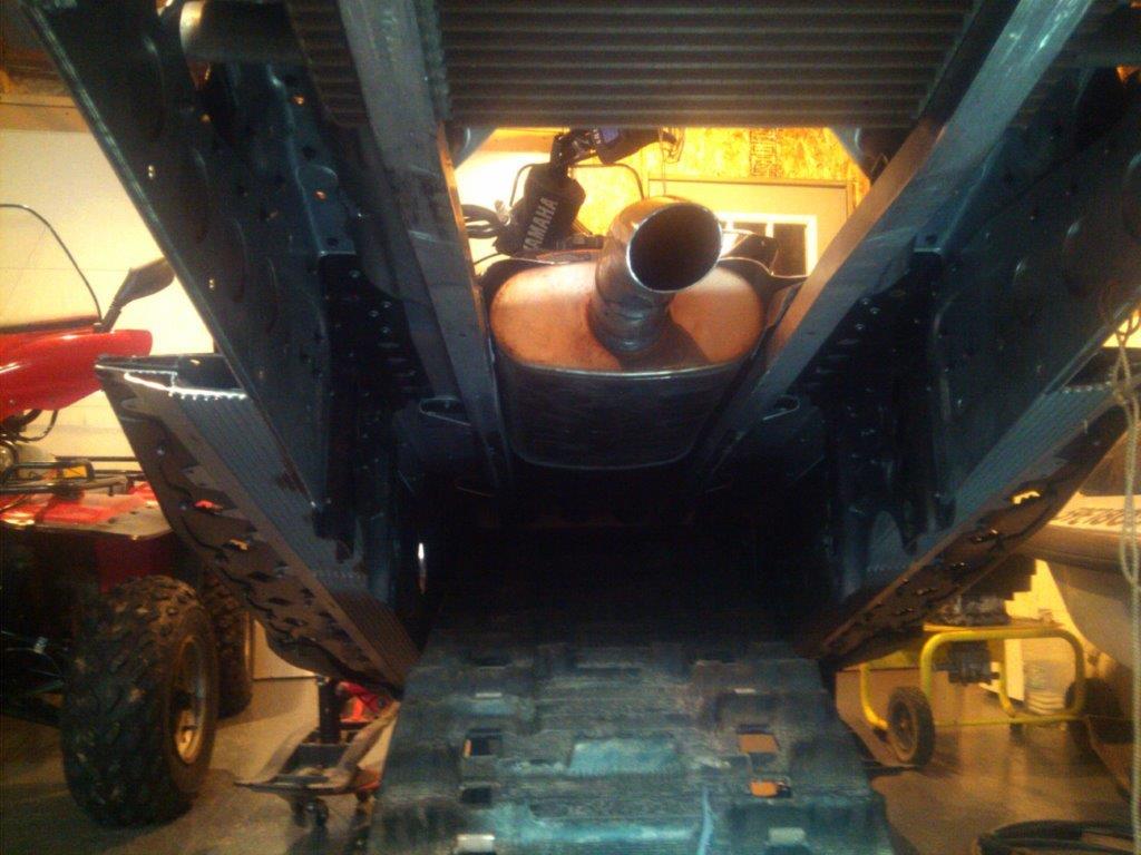

Here are some pics of the Magnaflow 11113 installed on my Vector ltx. Had to cut out the cast aluminum cross brace between the tunnel protectors and the muffler fit right in there. I need to put a reducer on the inlet of the muffler now to match the header pipe and then weld on a couple of support tabs to bolt the muffler on tight. Fit is really good and muffler only cost $100. I haven't fired it up yet but there is another thread on here with a nytro with a similar magnaflow and it sounds great, and hopefully not too loud.

Heck, I just now saw the exhaust pics you posted last fall. Will you have to re-jet for the muffler when you get it back on?

not sure how much this will effect the 4 stoke engine. I haven't done any jetting on this machine yet although I have heard of people who re jet the pilots due to a lag in the lower throttle range. I will definitely try it out first and look for any signs of running lean but I am not expecting to see a huge difference. Do the MBRP and Hauck trail setups require re jetting I wonder?

Clearance in the tunnel didn't change as I stayed with 1.25 lug height. I will have to use drop brackets when I go ahead with the new tunnel extension and magnaflow muffler as the top of the lug is almost touching the muffler. but that is easy enough to do.
