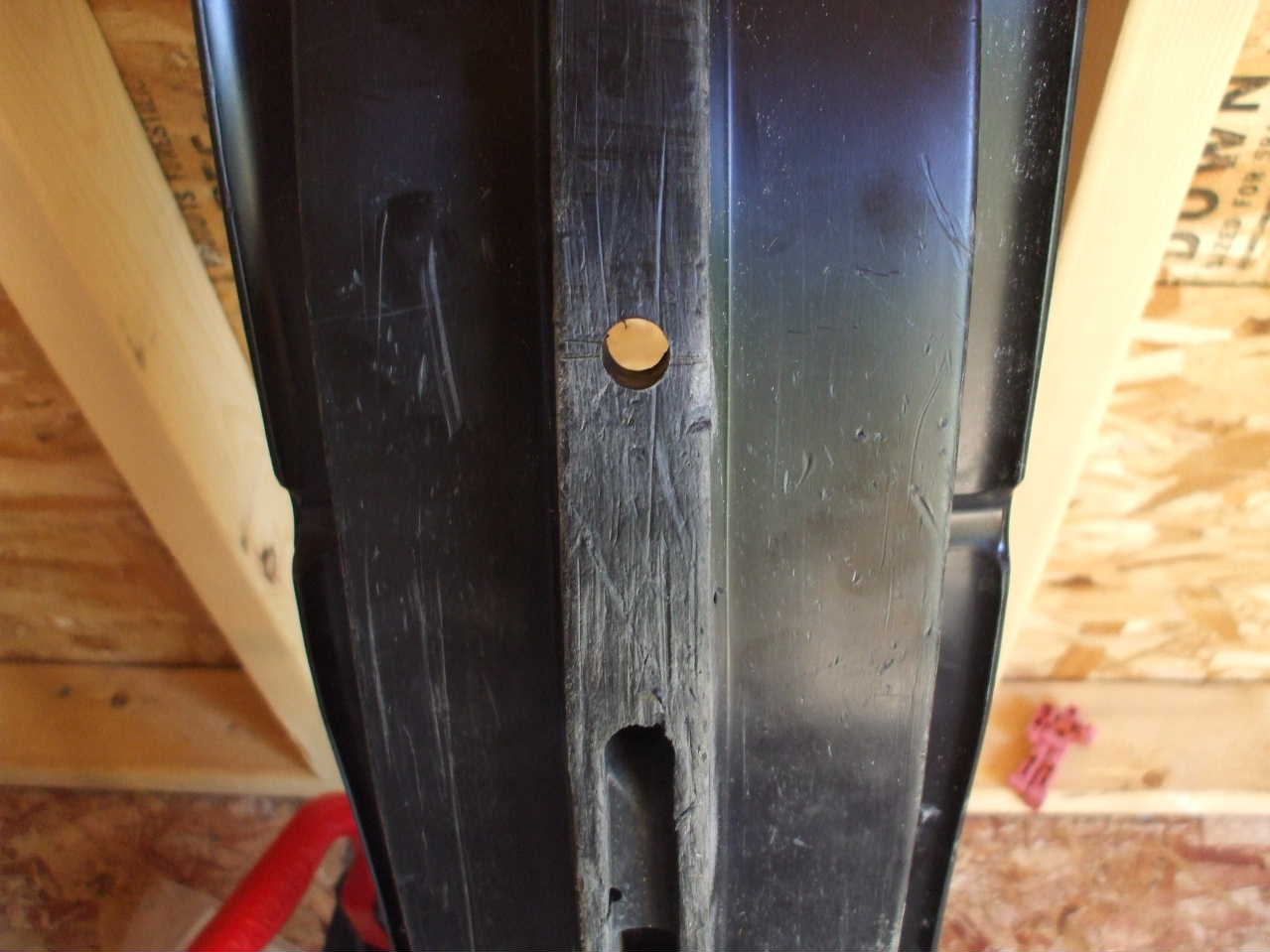

upei93 said:Put on my mountain skis today...
Hey upei93, how did you figure out where to drill that hole in each ski? Is there a specific measurement you know of, or did you just eye ball it?
Thx dude!!!

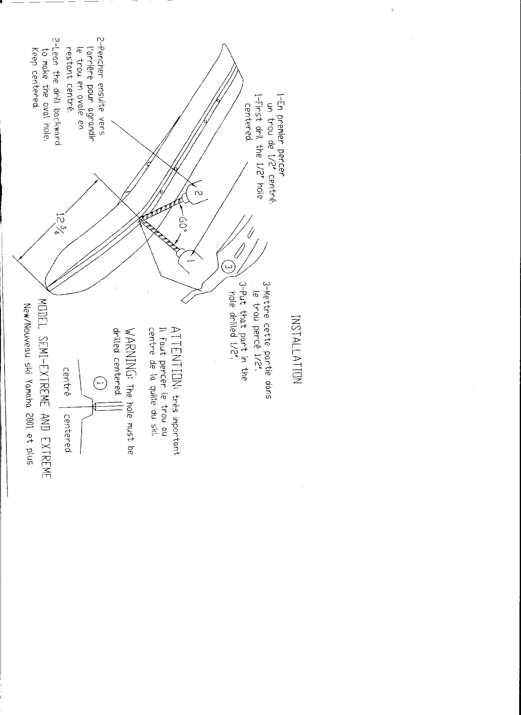

Super Sled said:upei93 said:Put on my mountain skis today...
Thx dude!!!
Mike[/quote
I just took measurements from my stock skis...I found this after I put them on.
