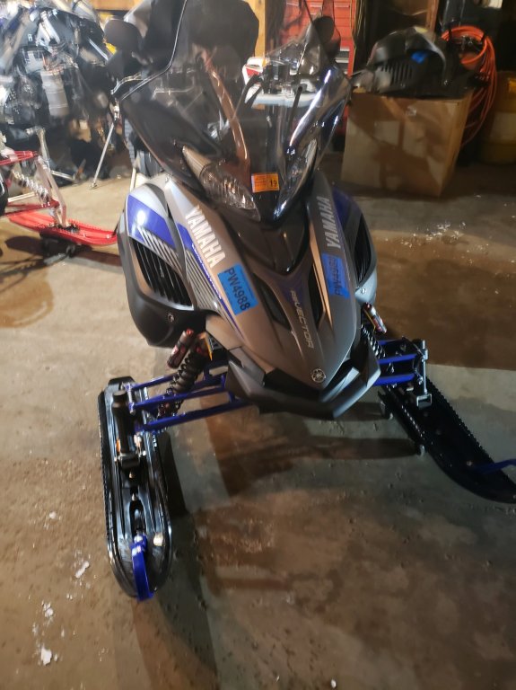

Mohawks ready to go. What hole did you put the saddles in. I mounted ours in the aft position.
I mounted them in the forward position. Have not tested them on the trail yet. So may have to move them back. They turn great in the powder.
