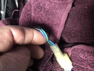

When I follow the brake switch wire down this is the connector . Possibly different plug over the years . Mine is a 2013 , anyone know which wire to tie the Blue wire from MSD launch master into ?That's awesome thanks !
kinger
Put a multimeter on it and key on, you want to the one that lights up when it’s pressed. Mine was a 2006.
