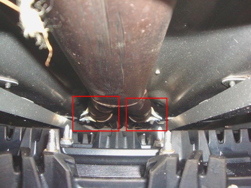

I'd like to remove the muffler assembly from my Apex to replace some loose rivets for the tunnel protectors (under the muffler) and for the crossover tube.
If remove the clamps shown in the photo below and the bolts holding the muffler to the tunnel, does the muffler assembly just slide out?
I have read that it is a tight slip fit for the muffler assembly to the Y-pipes. If I do remove the assembly is there a chance that I'd be able to reuse the muffler to Y-Pipe gaskets?
From what I have read it sounds like it can be difficult to reassemble everything if those muffler to Y-pipe gaskets need to be replaced. I will have my skid removed for service when I do this. I'd just like to know what I may be in for .

i reused mine... no prob... its a screen type "tube" gasket and as long as your carefull should have no prob...

Just did this yesterday to my buddy's sled. It was making some noise even after we did the donuts, upon further inspection when we dropped the rear skid the exhaust clamps were missing. Never were installed from the factory!!! Ordered two from Port, slid the muffler out, put on the new clamps and it slid right back in! Only thing you have to do is when you slide the muffler back to the Y pipes I had to pull down ever so slightly on the Y pipes to align the hole correctly, then it slid right into place.

Jst put new pipe on my dads apex, and it was quite difficult to get te pipe to actually come loose, but came off eventually, and we were going to reus the gaskets but there were wasted. New ones were about 16$ if im remembering correctly

I've always had a hard time getting the muffler into the Y pipes. They are a tight fit. I have my support bracket for the Y pipes in with SS nuts and bolts so 1 Y pipe can be pre-installed into the muffler and slipped into the tunnel and then I end up wrestling with the other one for half hour before I get it.

I replaced the stock muffler with the Sno Stuff rumble pack and had difficulty getting the muffler to separate from the Y-Pipe. Once I did, it may have been okay to replace with the original gaskets, but once you remove them from the pipes, they lose their original form and fold when you re-install. Had to buy new ones, installed with no problem. $30.00 for the pair.
