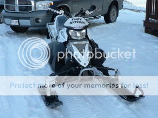

Well guys and gails Here are a few pics of my MCX phazer that I just added a Hindle slip on exhaust that a friend gave me for doing some work on his Snopro 440/700 conversion with him also i took the K&N filter out from under the seat so it could get better colder air as a few people suggested.I also put a set of bars off a 2006 nytro and added my Acerbis hand gaurds .The sled sounds way better with this pipe and looks cool too

the sputtering is most likely the rev limiter. han an s/c apex do it....had to throw some serious weight to the clutch to keep the revs down with all that extra power!
