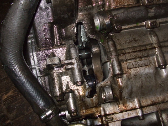

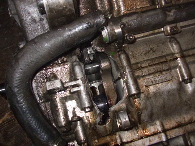

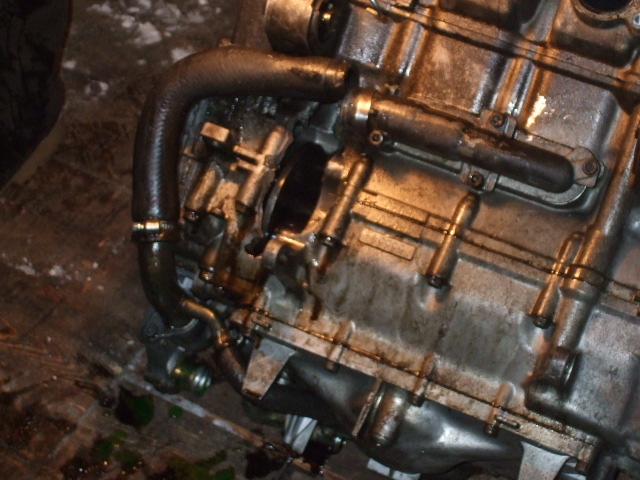

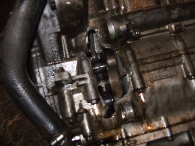

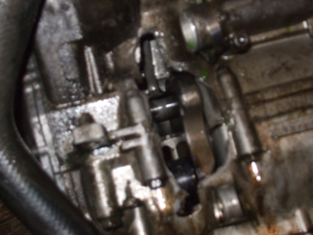

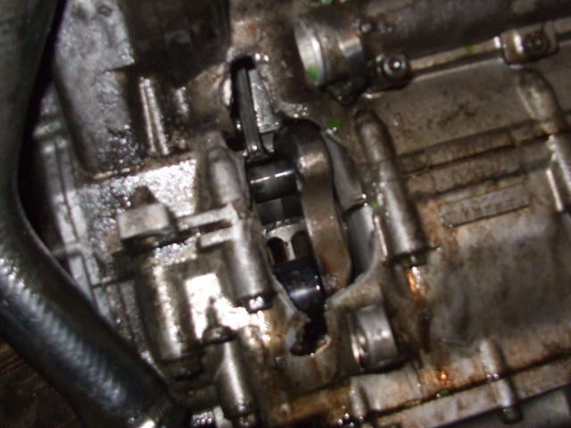

well guys. there is a huge hole in the base of the motor. crank is no good, connecting rod is snaped off and beat up....there is block damage, and piston is no good. i think 3 pistons and rods are usable. this was on #1 cylinder on the clutch side. here are some pictures of the hole!
let me know what you thinks of it!

srxguy
There is a whole motor for sale here in NY for 2400 I think..its at www.hud-son.com/snowmobile.html
ski-dood
That motor is toast. Part out the sled and buy another one. $2400 for a motor only is ridiculous. I paid $3000 for an RX1 mountain with 1900 miles. Even came with a brand new mesh hood and some other mod parts.
ski-dood
On second thought I have seen bottom ends for $800 before. But that makes me wonder why someone would have the bottom end only. Not sure what is available in your area but I was unable to find a good motor for a reasonable price...so I bought a complete sled and will sell the parts I don't want/need from the two. It can be a lot cheaper than buying a used motor...especially when you can't hear run till you install it.
