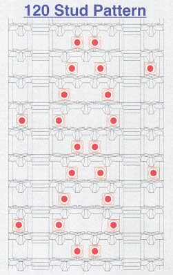

I'm using 1.375 studs with round plastic backers, I think. But I can't decide on a pattern. The sled is a 02 Viper with a Camo 9860 1 1/4 track. Anybody have a good pattern that they have had luck with? Thanks. 8)
This is the pattern I used. Can't remember what template brand I used. But it is a 3-2-3 pattern repeated every 8 treads. It works well as a safety pattern; as in icy cornners, stopping etc. But I would put in more if you are looking for lots more holeshot traction. Although mine is on the stock .92 yoko which may make a difference. Sorry for the crude drawing, but you should get the idea.

Here are a few more 120 patterns. But I have never ran these patterns.
I prefer Woody's 144 pattern (center only) - I'd avoid studding the outer belts entirely. Just remember that not having enough studs is bad too, and if you use a 120 pattern on a Viper that includes the outer belts, you will have a greater chance of tearing them - JM2CFPE
I put a 120 in my Warrior (1.375) and I never had any rip outs or anything hook up in hard packed snow with the ripsaw was amazing.Not enough for ice but I don't race on ice.You will be fine with 120 down the middle.

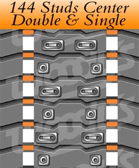

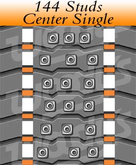

I agree with 4fighter, I would probably run 144 down the center if I was to stud my viper again. But I haven't had any tearouts or problems with my 120 pattern. It works, as I don't ride much icy conditions. Here are woody's 144 center patterns
There is a pattern for 144 down the middle - all doubles - it worked great for me - I broke 2 studs last year in 2000 miles - and I am not a stud friendly rider.

Thanks guys. I was wondering if I should go with 144 or not. I'm still a little undecided. But I'm leaning towards 144 instead of 120. I bought these studs from a buddy that wasn't going to use them, and he only had 120. I can buy 24 more and go with the 144 single/double pattern down the middle only. I like that pattern. Thanks for the pictures, they helped greatly. Thanks again, Chad. :rocks:
