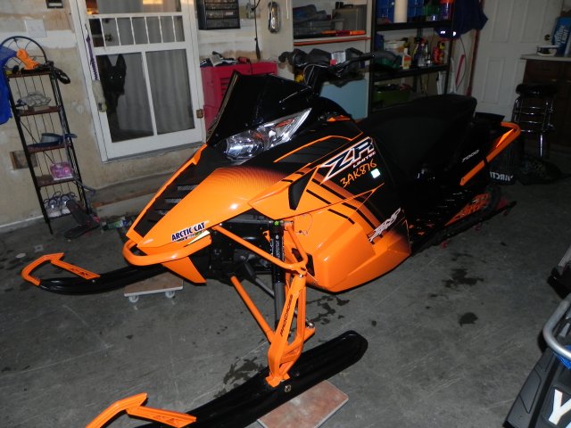

I bought a new 2014 viper rtx se because I loved the ride and power of my wife's 2014 zr 7000 sno pro ltd. Both sled are awesome they both been running flawlessly! That being said she can take me with her 7000!(her sled is pulling harder)
there is a few factors that comes into play such as she weighs 100lbs less then me, her sled has 300kms more than mine.
Both sled are identical both are the 129 track, she has 6"slim jims I have 8"slim jims, suspension set ups are close both have limiter strap pulled up 1 hole, front skid shock are loosened the same I have 85psi on the skis and she's at 75.
What can I do to redeem my manly hood lol...
I'm planning on purchasing a muffler from sandale and clutch kit
what's a good trail set up?
here's some pics of both sleds
