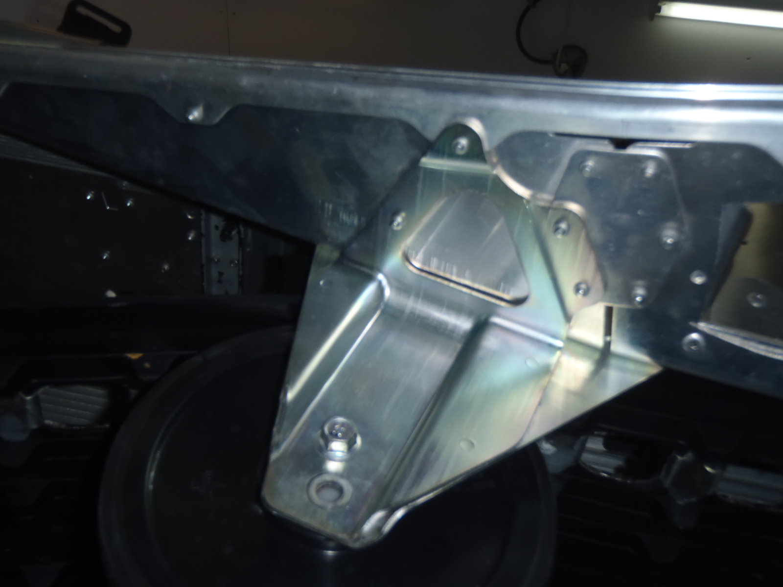

Been held up for weeks waiting for shocks for new mountain tamer, finally got all the pieces this week and will be leaving for a trip west on Tuesday morning.
Because this is being put in a XTX (putting in a 162" though) This is a little bit of a custom install. Allen has been trying to help, but does not have the measurements for the rear drop brackets (they do not make them yet for my tunnel which is the same as a nytro SE)
I desperately need the measurement down from the running board for the rear hole, and a picture or two would be great as well. I am pretty comfortable that we have the front hole where it belongs, but do not have access to a mtx SE.

towerrigger
yammi4ever
Thanks,
So it looks like it is 4 1/8 inch down to the center,
What is the other hole for, looks like you were in it at one time.
Thanks again
Thanks again
towerrigger
Used the bottom hole when I run the 2.5 CE. I have a under tunnel exhaust, I need the extra clearance.
That looks correct to the upper hole and 4-7/8" to center of the lower hole to me.
