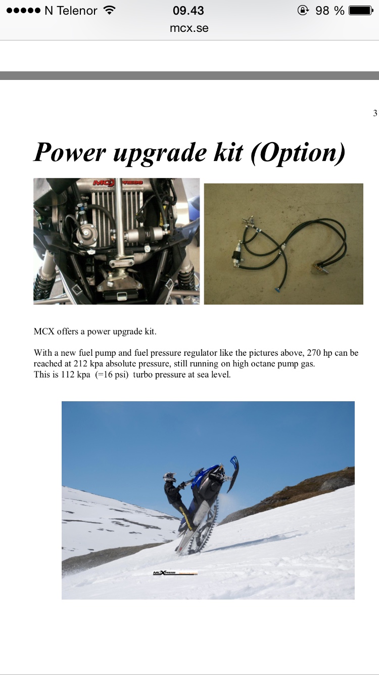

The old pump has been removed and upgraded to the kit shown above. all fuel lines/filters are new.

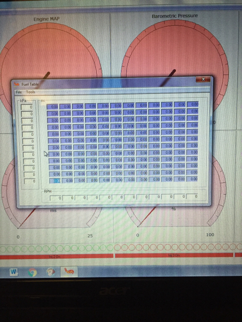

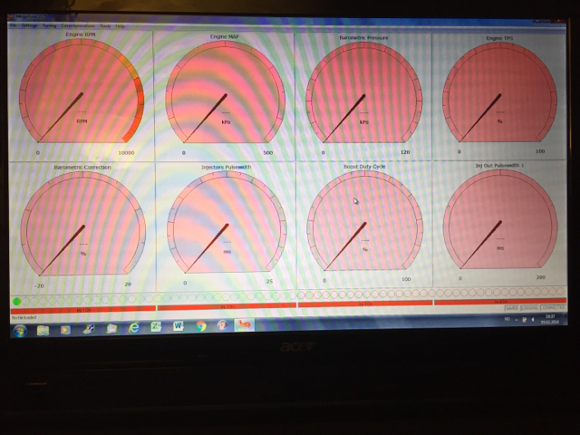

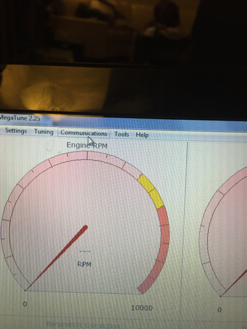

After some more digging I am leaning on fuel mapping of my controller being incorrect after I put the new injectors in the secondary fuel rail. My friends Turbo has the original injectors in his sled from MCX and I have changed mine and had it remapped, but I am thinking that the mapping was not changed. my Understanding is that the MCX (black injectors are larger than the ones that I have installed. Unfortunately I do not have the black injectors readily available to switch back to try this theory.
the throttle comment was just a reply from a comment above. I was assuming that he meant that under boost the pressure would push the throttle bodies off the intake. Since I have no leaks I would think that the clamps are tight.
Stigapex
Suspended
Then you must remap. I assume you have mcx gen 5. Megatune is the software. Send a mail to mcx, I'm sure they send you the program.

That's the only thing I don't like about my MCX, to much Fing around to tune! The Nytro I just had built is using the Dobec gen 4+. You can't control timing with it but the new gen 4+ that's coming later in the year will be capable of timing control. Very simple to tune and controls from set AFR using an o2 censor so set it and forget it. The controls and AFR gauge is one unit. So far I like it!

I know there is an autotune available for mcx gen5, but I haven't tried it, so don't know how it works.
I bought a timing-controll from Ulmer. That works ok
