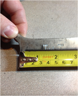

on my 11 apex keeps picking skis up in turns. And I adjust from clickers every way possible so now I'm going to have to play with transfer rod. But problem is I don't have the factory tool to get the measurement for min n max distance in and out.. I do have manual but no wrench.. Can some one measure it with a measuring tape and tell me the distance in and out is that possible, then I can use a measuring tape on mine.. The more threads showing the more transfer makes the skis come up on turns correct??

The more threads showing the more transfer for sure. I think you may find ski lift will happen often on corners where ever the rod is set but give it a try? did you get the measurement yet? if not let me know and I will measure mine for you. It is an o6 but the measurement is probably the same. hopefully someone will chime in and confirm.

No I didn't get the measurement yet.. And also looking under the sled my limiter strap is in the top hole towards seat is that where they are suppose to be?? Or more towards the holes towards the ground?? Thanks!!

I have mine in the middle for the strap. I will fix you up with a pic shortly. Where abouts on PEI are you from? Storm day gives a fellow time to catch up on the forum talk instead of being out riding eh!

Here ya go! Sorry its a little blurred. If you decide to go out at some point I wouldn't go past the 2 inch as I have heard that it can pull apart and cost you some $$$$.

Ya for sure thanks
