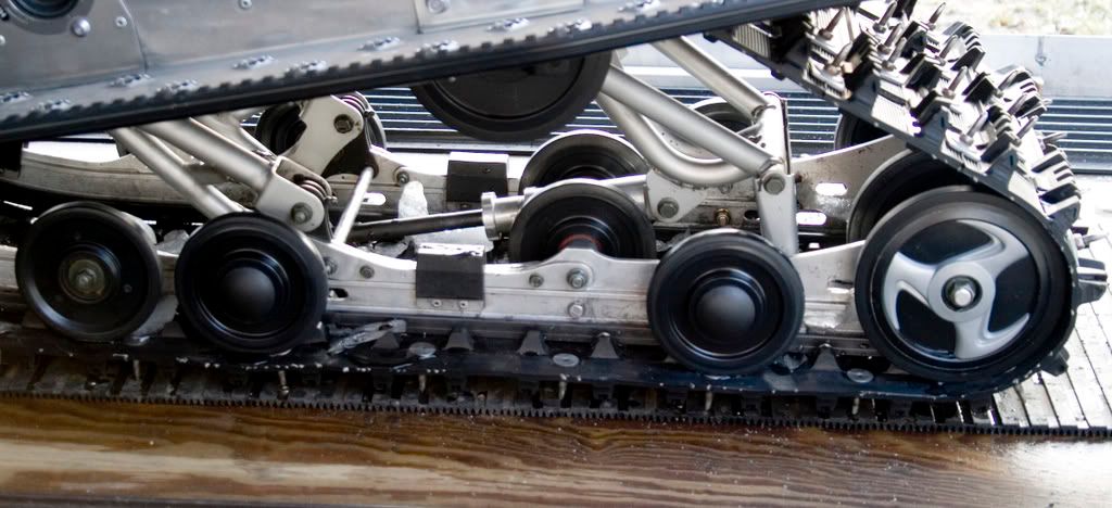

I replaced mine with the Doo 135mm wheels with their 2 bold mounting blocks and added an extra set in-between the rear idlers and the rear wheels.

mark...I like your job...maybe I'll yank my skid and you can give a few pointers
Iceman57
sj said:mark...I like your job...maybe I'll yank my skid and you can give a few pointers![]()
Let me know, I'll be glad to help!

Skid's out...adding new zerks and powder coating...ready to change the wheels around ....whenever your ready mark..p.m. me!
