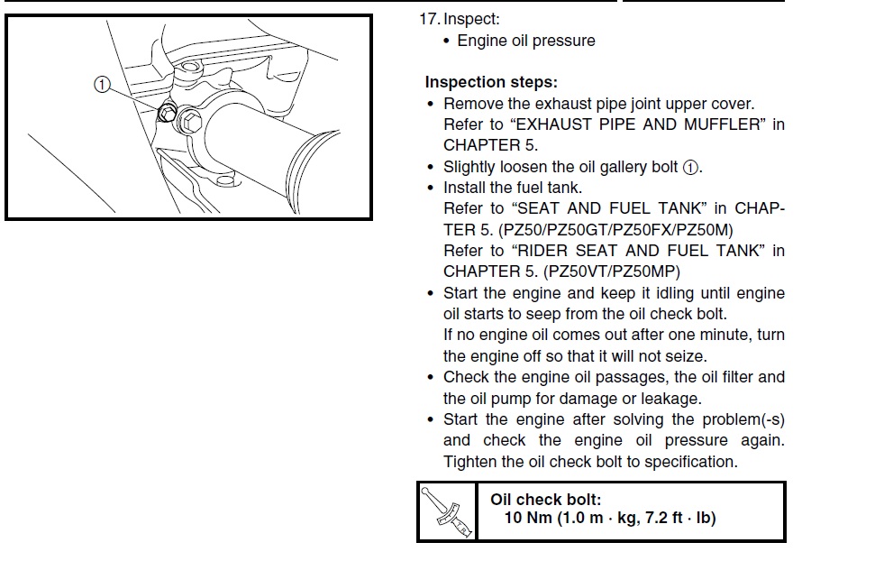

There is also a bleed screw.Never needed to use it myself but maybe the turbo lines get air in system at oil change.
