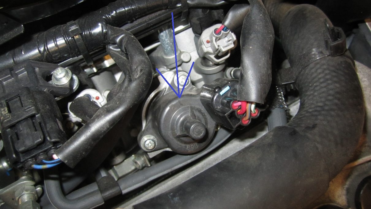

When I turn my to key to accessory or when the I turn it to the off position I get a buzzing/rattle sound. I wasn't sure if this was common with Nytro's and I hate noises so I traced it down. I have no idea what the thing is that is making the noise so I attached a couple pictures. It is attached to the throttle body and does not appear to be a replaceable part.
So, can anyone tell me what this is and if it is normal for Nytro's to make this sound?

EBRS? (engine brake reduction system) It keeps the clutch engaged slightly when off the throttle. Just a guess though. Its really noticeable on my quad, when I cycle the key.

I know the exact noise you're talking about...but I have no idea what it is. I just accepted it as normal.

Looks like the fuel presure regulator.

In our automotive world, we call it an IAC valve. Idle Air Control, its what keeps the idle consistant. The noise must be the valve moving thru its prove out like you discribe.

Rx1mtn is right Thats the EBRS solenoid, also used as the IAC valve. All the EBRS does is keep the throttle open slightly till speed comes down. Normal noise..rx1mtn said:In our automotive world, we call it an IAC valve. Idle Air Control, its what keeps the idle consistant. The noise must be the valve moving thru its prove out like you discribe.

As long as the noise is normal, I am good with it. Thanks for the help.
