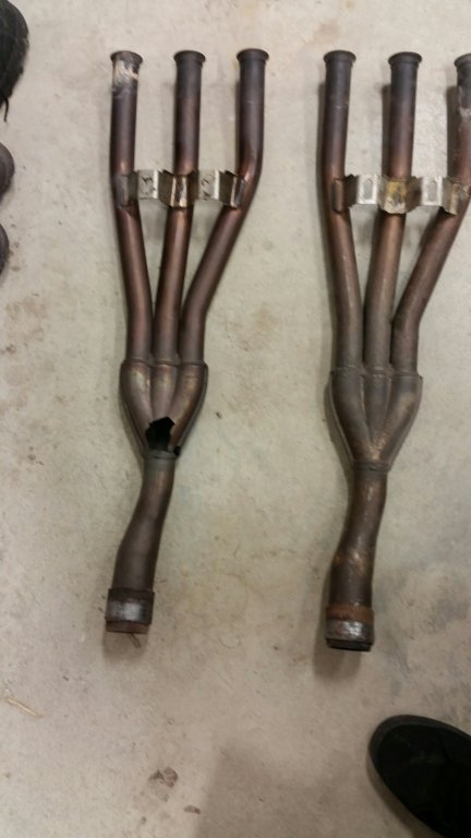

Well I must have jinxed myself. Last weekend my sled got way louder during my ride. To the point my ears were ringing by the time I got home. With the sled running I plugged the exhaust with my hand and it kept running fine.... I thought maybe my donuts were shot so I started pulling it apart and found this.
I believe this was caused because the exhaust I made had no support between the rear mount and where it connects to the header. 2 seasons of extra stress on the header and this is the result. Luckily I found someone selling a used header locally and put it on, along with my stock muffler.
