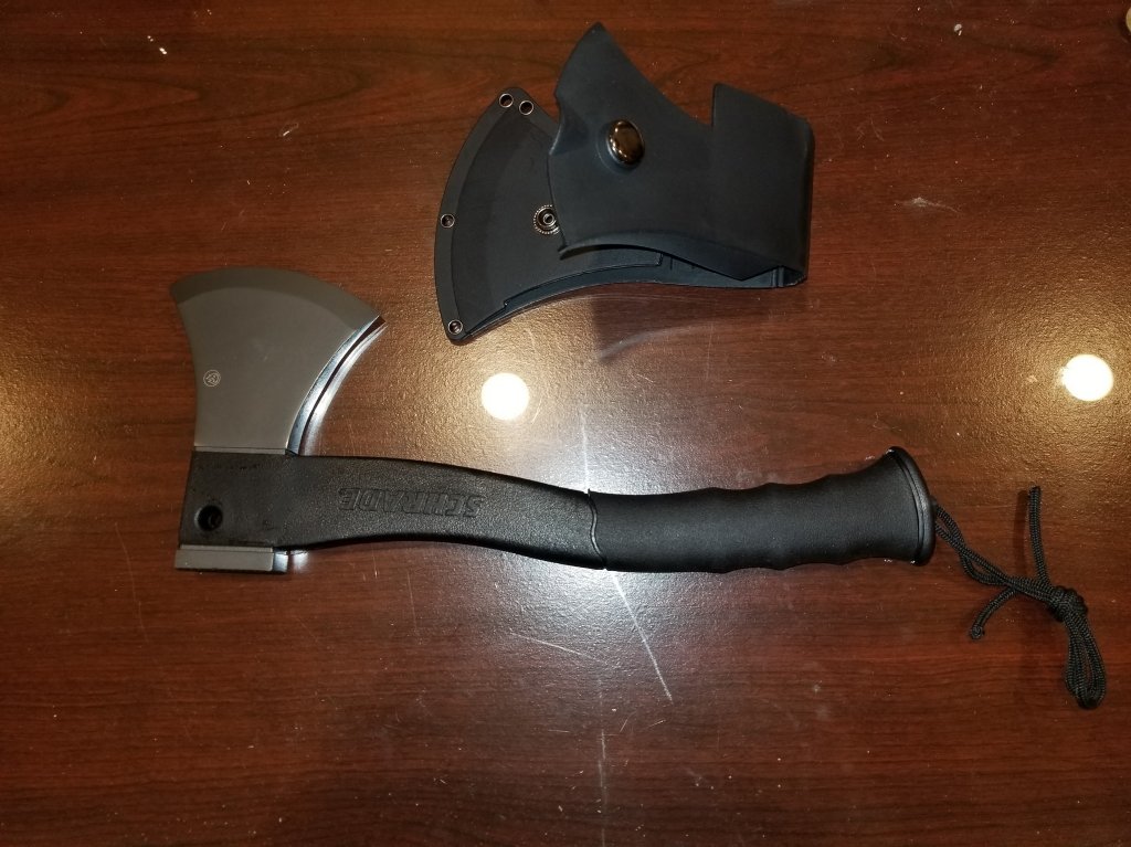

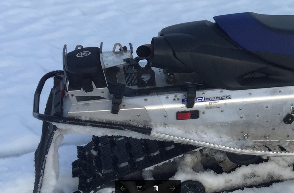

I have the stock Yamaha rear rack on my XTX, it is very functional. It has a waterproof roll bag and a smaller nylon bag. I have two clamps mounted in the space between the exhaust and the rack for my survival hatchet / fire starter and the blade protector fits perfectly under the rack (see pics). The deflector is not in the way as far as storage space goes. If you remove the roll bag, a 1.3 gallon fuel jug fits perfectly although I am not sure I need that much extra fuel as I have the trail tank and always fill up when I pass a gas station if I am in doubt.

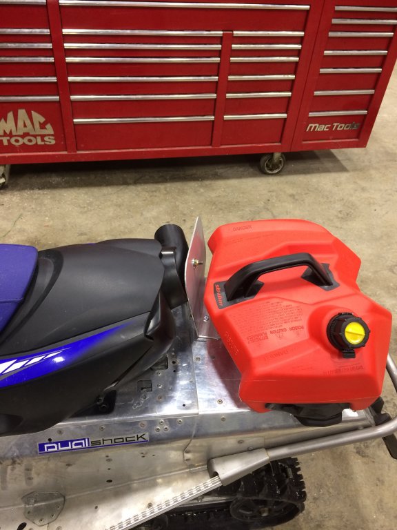

This is the 1.3 Gallon Mountain Addiction fuel jug that should fit in the space the roll bag goes. Alt is the Long Haul fuel jugs on the rails similar to another post, I like the black fuel cans so hard to find.

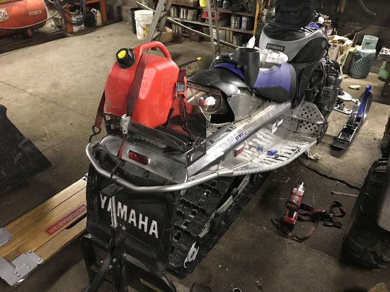

Installed the rear axle and my own 4th wheel kit tonight, put the rack mostly on yesterday and did a little bit of trimming. A 10lt Scepter jerry can just fits inside the rack. Have to put a couple more pieces of hose on there just to protect the sharp corners. Going to look for some decent heat reflective tape as well. I wont be riding on trail much but occasionally. It might not look pretty back there but where I'm headed I'm going for function not looks. Have about 260 miles to do in a day with civilization in only once spot about 1/3 of the way through and then at the very end again.

Does anyone know the part number to that little Yamaha bag on the factory xtx rack pictured above?
