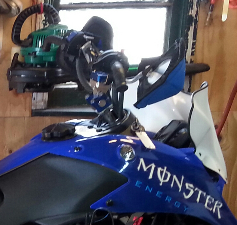

I want to put a 6-8 inch adjustable riser on my Nytro XTX. I bought the rox riser, rsi pivot adaptor, powermadd extended brake line and powermadd throttle extension kit. Is this all I need? I saw someone had an issue with codes on a Apex. Anybody do this without issues?

the code that you can end up with is the TORS code. can't remember the number but it is caused when a difference in throttle position from throttle body position is detected. happened to me last year when i stretched my stock cable when using a riser. once adjusted correctly (instructions in owners manual) there will be no issue. 6 inch rise is really tall, i'm 6 feet tall and with a 3 inch rise my arms are bent slightly while standing, perfect for me.

If I remember right its code 87 and you will know.

I installed a two inch Rox and an OFT relocater. I am 6' tall. Haven't rode it like this yet but seems plenty tall. No issues with cables or lines.

I ran 2 inch rox risers last year and it was perfect. I added the oft relocate and didnt put the riser back on.

Thanks for the responses! Sounds like 6-8 may be too much, so I'll try the 4-6. I'll also look into the OFT relocater.

I'm keeping the stock bars. I think I'm going to try the 4-6 inch riser instead. After reading the responses I have some more research to do first
