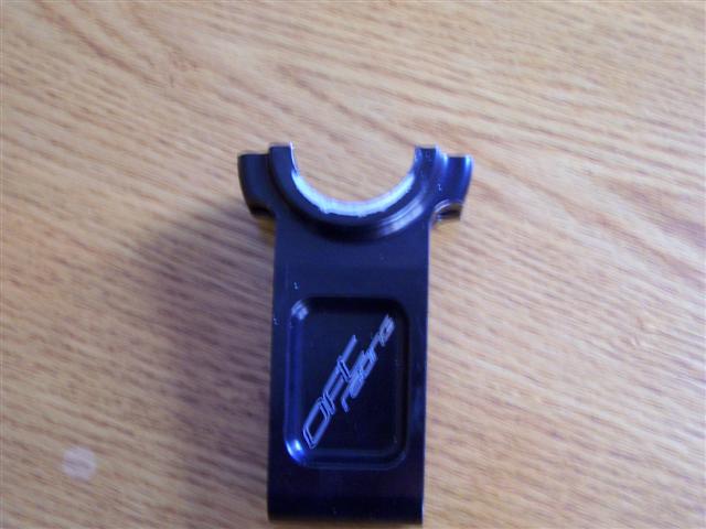

I just installed mine and it is very stiff. Both Blocks on the bottom slide perfectly on the bolts too. Tall Bushings on the top and short ones on the bottom. But when I tighten it up, it's really stiff. Here's a pic of what happened to the OFT. Not sure here.... Scott is sending me a new one... Anyone else have this problem? Any help...

The steering shaft is rubbing on my OFT. I don't think it should be doing that. Hense the reason it is so hard to turn.

Yes, but I'm not sure I want to back it off. I want it tight, so I can have confident that the cap is not going to pop off. You should be able to have it good and tight. I can have the stocker tight.
could it have something to do with the powdercoating? mine is just silver and it worked great... mine you I didn't have the skis suspended, my sled was on the ground the whole time...
hmm, this is kinda strange. When I installed mine, I noticed a nice tight steering post, no real increase in steering effort.
Something isn't right.
OFT will make it right. I wouldn't worry about that one bit!
if I had to guess, I would say the variable is the fact that the lower studs have to be bent, allowing the possibility of different results from person to person. again, anything like this should be studied and tested each step by installer and quite possibly some help from a diegrinder with porting sand paper
aha
looking at that relocator, id say the steering colum wasnt lined up with the way the locater wanted it to be positioned. he had it bound up somewhere.
bending may have been off, blocks not sitting flat on frame. like gilbert said.
did you put the bottom block with the base piece going from thick at the top to thin at the bottom and with the angled piece flush on that bottom mount...?
Mine has the Same marks..let us know what the problem with yours was.Does anyone have a copy of the installation instructions they could post on here? i want to make sure i installed mine correctly but my instructions have gone missing.
