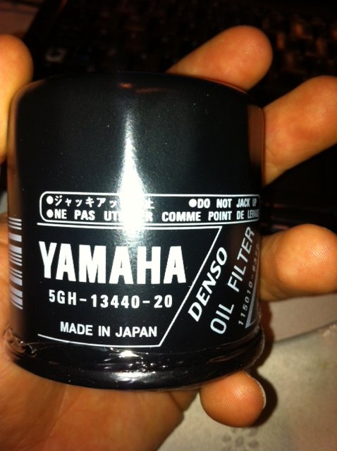

Can someone tell me or lets me know where i can look up Oil Filter Part# for an 06 Apex and 09 Nytro???
Thanks Owners manual does not list it
Ive got 5GH-13440-20 but not sure if its right

5GH-13440-20-00 for the Apex
5DM-13440-00-00 for the Nytro

yamahas said:5GH-13440-20-00 for the Apex
Are you kiddin me??? Dealer sold me 5GH-13440-20-00 For my Nytro

Daranello said:yamahas said:5GH-13440-20-00 for the Apex
Are you kiddin me??? Dealer sold me 5GH-13440-20-00 For my Nytro![]()
I am not sure what the difference is, could very well be the same filter.

the only thing different is how tall it is

yamahas said:Daranello said:yamahas said:5GH-13440-20-00 for the Apex
This is it??

I am not sure, I just pulled the # from the diagrams.
If the difference the the lengh I would bring it back and get the right one. I remember reading about wrong filters getting cut when they are too long in the Nytro.

yamahas said:I am not sure, I just pulled the # from the diagrams.
It says (short) on the dealer part sticker??

All Yamaha 4 strokes beside Phazer run the 8DN- belt.
All 4 cyls run 5GH filter
All 2 and 3 cyls run 5DM filter
5GH and 5DM filters DO NOT interchange.

5DM filter for nytro is definitely shorter. They are about 2" in length. I have not seen another manufacturer with one this short. Like said before, if it is too long it could rub against the metal rails of the underbody cover or skid plate. If your paying the money for the Yamaha filter should just take back and get the right one....
