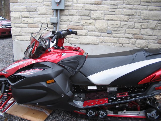

don't bother painting , it will just rust again, powder coating is the way to go, I purchased a do it yourself kit from carswell plating and bought a used electric oven. I powder coated everything that could fit in an oven. you would be surprised how much you can get it the oven. all you need is a small compressor , the starter kit from carswell and a used electric oven. run a 220 volt plug to your electric panel and your all set up. do it outside so you don't get fumes in the garage, powder can be bought on line from a number of suppliers. very easy to do, I was amazed with the result. for under 300 dollars you will be up and powdercoating. It will pay for itself the first time you use it, the metal has to be clean, sandblasting or wire brush on a drill works fine. its take a bit of time and practice but you will get the hang of it. you will also need to buy a good mask, don't breath in the fumes, best too put the oven outside if you can when you are baking the items. attached is a picture of the sled, I did the gas cap, a arms, all the suspension , handlebar riser. works on aluminum as well.
